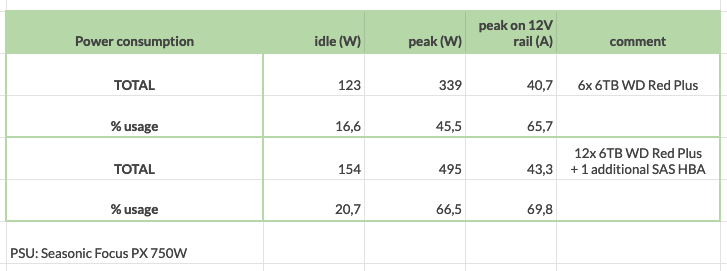

I am about to build my first FreeNAS / TrueNAS and I am looking for some PSU advice.
I've got these components already:
  • Supermicro X9SCM-F
  • Intel Xeon E3 1230v2
  • 32 GB ECC 1600 RAM
  • 6 x 6TB WD Red Plus
Case, PSU, Boot SSD (2x) and SAS controller (1x or 2x) still to buy.
I am planning to use only 6 drives (1vdev) for now, but maybe get another 6 drives next year.
Thanks to the excellent guide I did some calculations for the PSU. The calculations also include 2 Boot SSDs, Fans, HBA SAS controller. This is what I came up with:
Is 750W enough? Or should I calculate more generous?
Unfortunately the Seasonic Focus PX 750 (80 Plus Platinum) are hard to get in Germany right now.
Seasonic Prime GX 850 (80 Plus Gold) would be an available alternative.
Thanks

DanP.
Apr 2, 2019
17
Thanks
Hi again,
I will order my PSU today.
Do you think 750W is a good calculation for a Supermicro X9SCM-F, Intel Xeon E3 1230v2, 32 GB ECC 1600 RAM and 12 x 6TB WD Red Plus?
Or would you go with 850W for possible future upgrades?
Cheers
jgreco
Resident Grinch
May 29, 2011
18,680
750 is what the first post suggests for such a setup. If you are planning to expand later, then you probably want to give some thought as to what sort of expansion that might be.

How did you come up with 375? The numbers I ran years ago for an Avoton C2550, still among the lowest wattage systems available, would work out to 437 watts with 10 drives, and after derating considerations, that puts you solidly in the 550W (maybe 500W) PSU category.
We occasionally do the exercise of "but but but it's oversized aren't I wasting dozens of watts because some random idiot blogger on the Internet said so." You don't know me from any random idiot blogger, but I show my homework and reasoning, and as an added benefit, I do servers professionally.
It usually comes out that a larger PSU is probably only eating an extra few watts, as in this recent discussion, and the insurance against brownouts that could damage your system is probably worth it.
Obviously, you are free to do as you wish, having been offered an informed opinion and the data backing it up.
Thanks jgreco. You're replies are very much appreciated. I'm trying the make the best discussion for the PSU not to save a few bugs by buying a smaller unit. I spent a lot of time to find the right specs, and still I'm not sure I have the values I need.
This is my calculation:
Supermicro mainboard M11SDV-4CT-LN4F - 25 watt
processor AMD EPYC 3301 TDP - 35 watt
2 memory moduels 16GB ECC - 12 watt
HBA controller - 10 watt
10 x seagate ironwolf 4TB - 216 watt
Startup current of the drives 1,8 A (1,8 * 12 is 21,6 per driver)
5 cases fans - 75 watt
2 Transcend TS32GSSD370S 32 GB SSd - 2 watt
datasheet only mentioned max write speed of 180mA. Operating on 5V is less then a watt.
Total 375 watt
