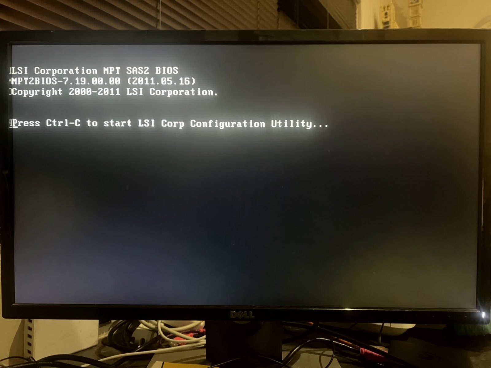

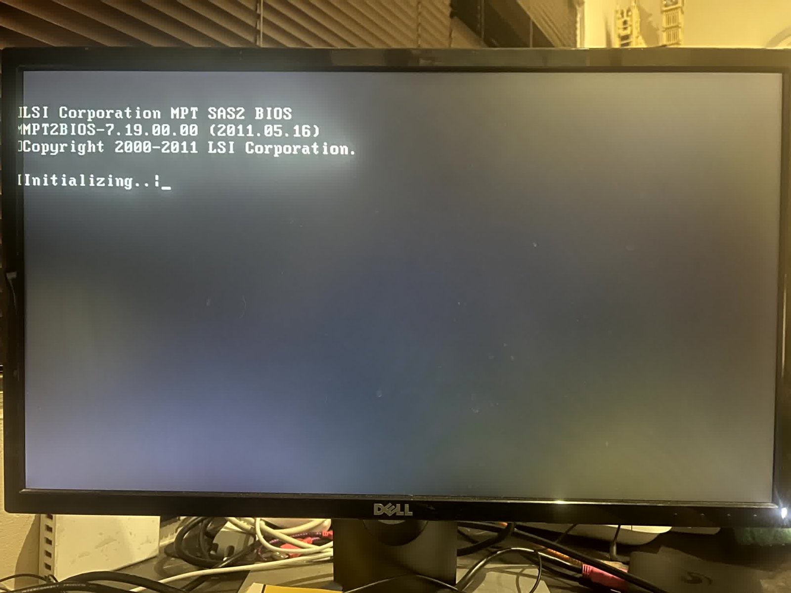

Hi all, not sure what went wrong where, tried to log onto flex, did not respond, went onto the NAS, saw some errors on some of the pools, but nothing seen before, that does not clear itself.
tried to restart plex, did not want to... so issued a reboot of the NAS,

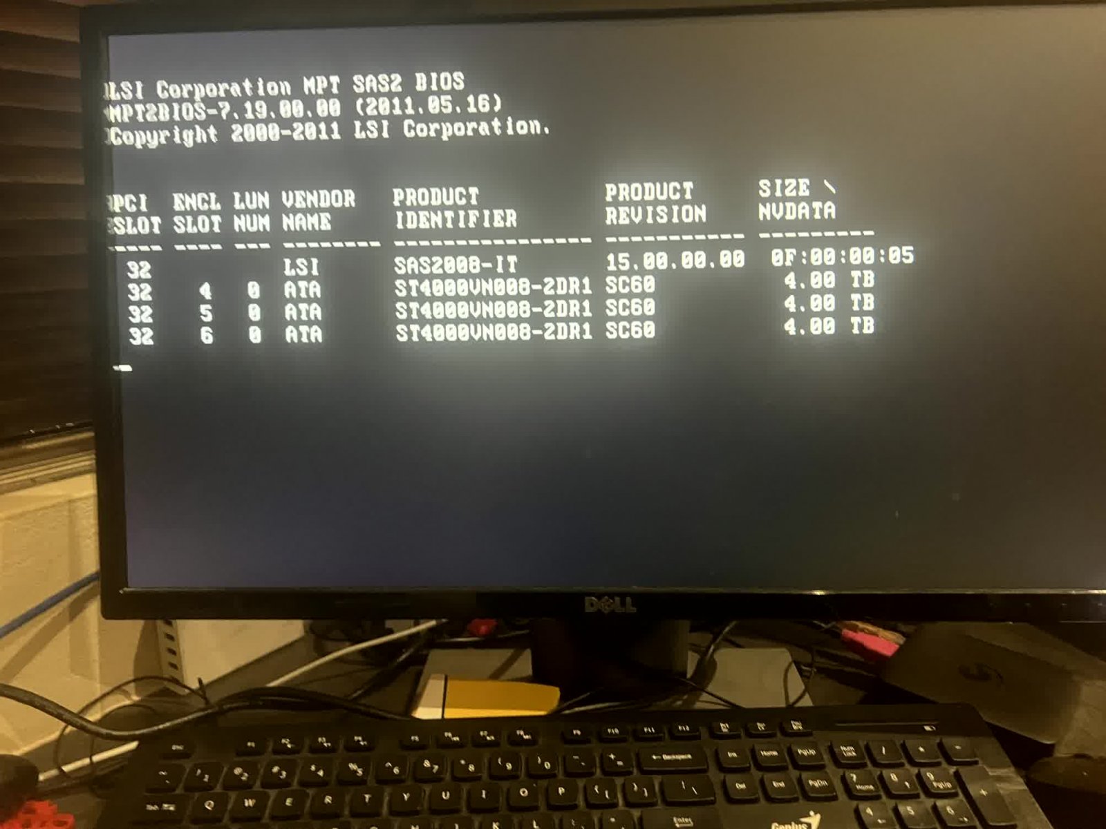

it now comes up, BIOS, then kicks over to LSI card, shows 4 buses as per attached and then cycles back to bios boot up screen.

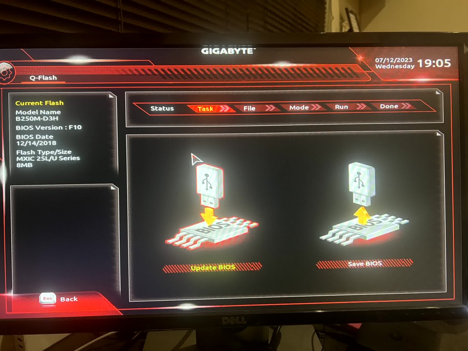

although I eventually got into my bios, it does not want to move away from the update bios / save bios screen.

That's not a BIOS screen, it's a QFLASH screen that can only be used to either update or save your BIOS.
Your boot pool could have died.
please explain this a bit more, i know about bios on mb and i know fw on expander cards like a LSI.

also thinking #6... if you see one of the photos shoes where it is showing scanning by the LSI card and then output from that, making me think we've gone pass ignition bios startup.

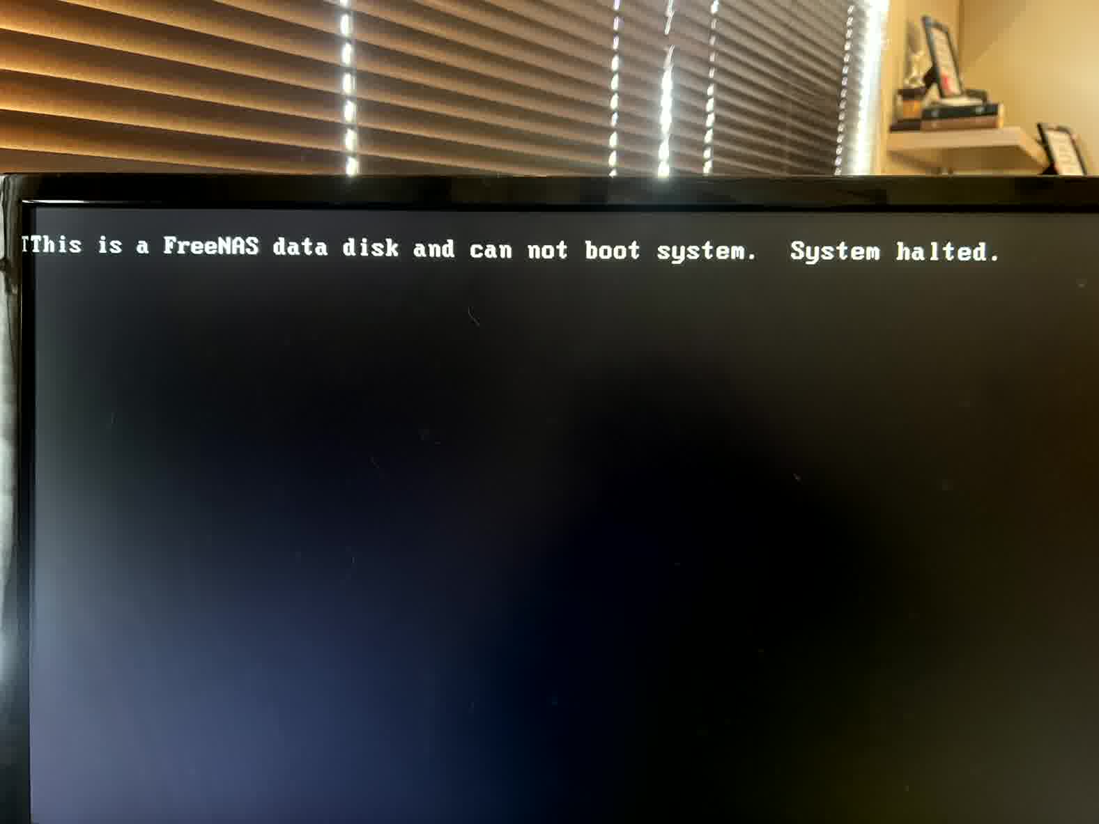

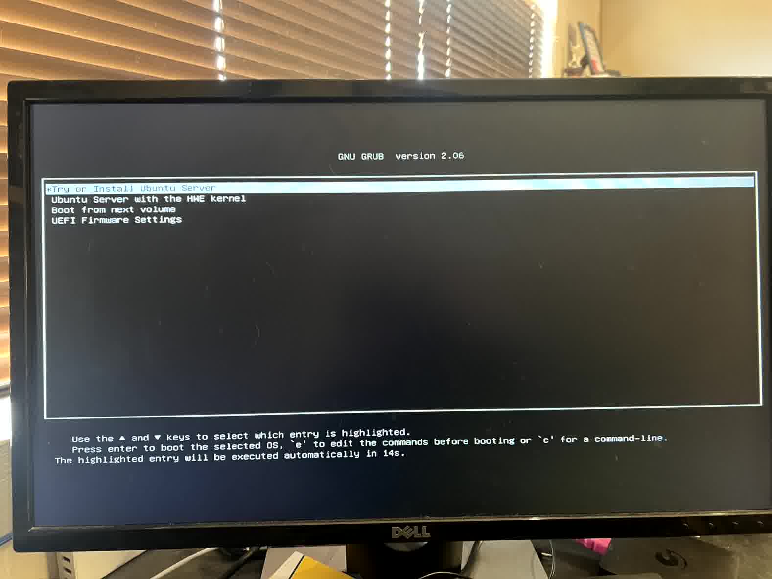

so... a little update
I first just unplugged the cable with the HDD that goes into my LSI controller... no change in behaviour. still does LSI scan, showing the devices plugged into it, then cycles back to bios boot screen,
I then removed the LSI controller which now (much faster) took me to a line that said
"This is a FreeNAS data disk and can not boot system. System Halted"
Now i restarted system, went to bios, reselected my boot device => external USB
(I plugged in a Ubuntu bootable USB.) and let it boot onto this (I want to see if the Ubuntu installer see 3 drives (plugged directly into MB) or all 7, 6 x 4TB HDD + 1 x 128GB M.2 SSD, excluding the boot usb), and surprise... it saw 6 HDD's, no mention of the M.2 SSD,
Guess this is good news, it means my LSI controller works.
What is/was/suppose to be on the M.2 it is a App boot pool, so things like Plex, qBittorrent, Unify controller and a FreeBSD Jail running some random apps like network speed tested + influxdb.
so bit perplexed, if that's whats on the M.2 why is it not booting... it should just have a problem with the pool.
some more fault testing.

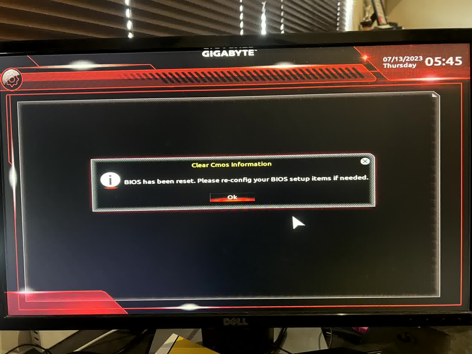

m
You entered the motherboard's utility to flash its own BIOS, not the BIOS interface.
right have hit think end or del which does that... while it was all dead, trying to see if there is life anywhere... if the KB batteries are good... it's a BTLE KB... and was worried some of my it's not listening to me might be the KB, since just switched over to a cabled KB to make sure i'm not fighting myself.
ok so all indications are the MB is ok,
G

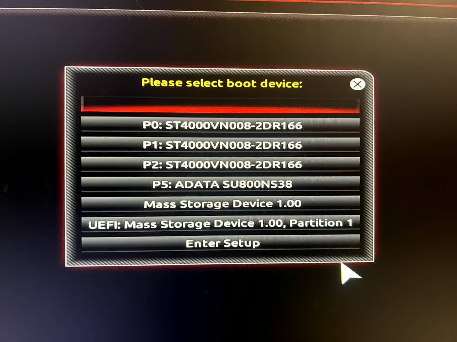

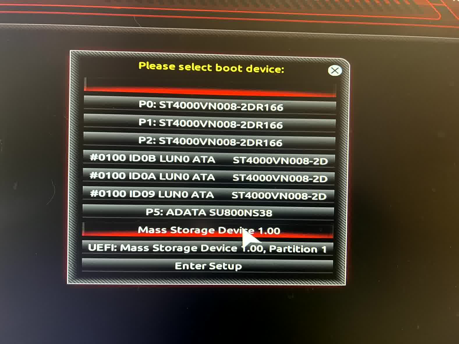

interesting, after removing the Ubuntu usb, and plugging the TrueNas boot USB back, booting and going back into bios to select boot device.
(it's seeing all 6 HDD's + the M.2 and the external TrueNas boot device).
Notice the list of possible Boot devices having change from early... to later. only thing i did was removed TrueNAS usb put in Ubuntu check it booted and then went back to TrueNAS boot device.
Can't recall if the boot device was tagged UEFI or not, having to try both. first try still took me to "This is a FreeNAS data disk and can not boot system.... "
G

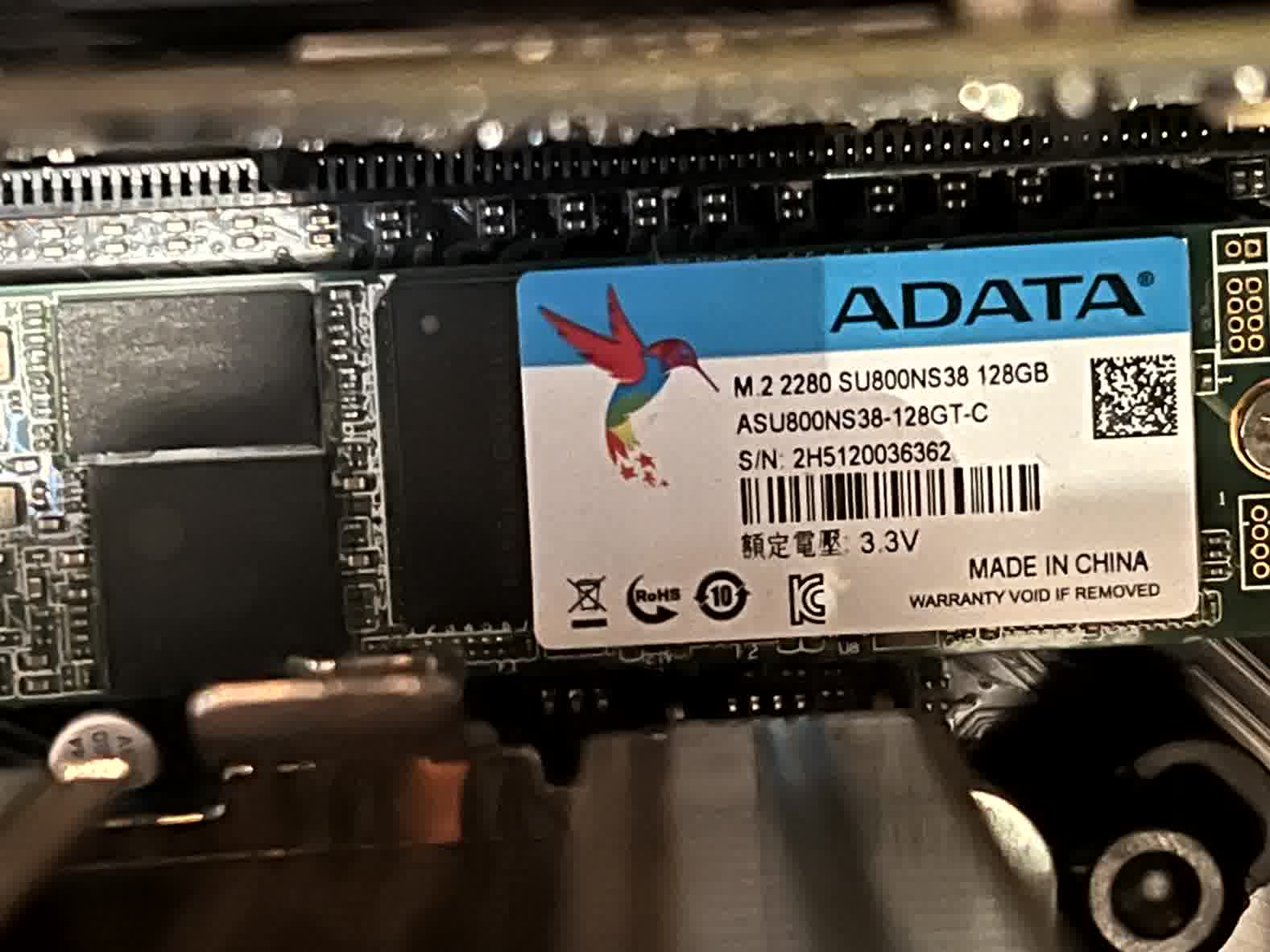

georgelza
Feb 24, 2021
417
wondering if the TrueNAS USB boot device is on the way out... - will look at replacing this. to be sure,
see attached, do believe my M.2 is gone that house App pool. - have some brand new 500GB SSD's I can put in. have 2, so can do a mirror pair.
options ?
happy to consider switching to scale, while we at it.
to consider :
  1. Plex install - MOST Important , the data is spread over 2 pools located on the 6 x 4TB HDD's, app is on the M.2 SSD
  2. Unify controller [have a export/backup],
  3. qBittorent - no sweat, simple reinstall
  4. BSD Jail, can rebuild
G

georgelza
Feb 24, 2021
417
so a boot took me back to this is a FreeNAS data disk, and a halt of system.
doing another power cycle
reselecting the boot device.
need boot stability before anything else.
G
georgelza
Feb 24, 2021
417
Not really a need to mirror the boot pool.
the device that's gone is not a boot pool, it was my app pool, where apps was installed.
think i happen to run into multiple things here.
the app pool failed, and at the same time it seems to be having a issue sticking to the correct boot device=> being a smallish USB
G
