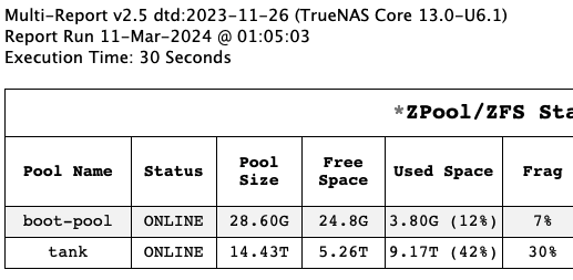

15,504
By and large, this script is working great on two systems, one with CORE, the other with SCALE. Except...

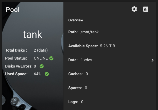

The CORE system has a two-disk mirrored pool, and the capacity reporting isn't quite right:
9.17 TiB used out of 14.43 would be 64% used, not 42%, and that's what the system shows on its dashboard:
zpool list and zfs list do seem to produce some inconsistent output:
This would be normal with RAIDZ, since the zpool application is unaware of the space implications of RAIDZ (or DRAID, I guess).
With mirrors, it's definitely weird. I just checked a few machines running mirrors and they all show the same value with zpool and zfs, which matches my understanding of how this should work.

First of all, thank you for bringing this to our attention. You should know that I'm all about accuracy.
Is it reporting correctly for SCALE? Assuming you have a similar situation there as well.
Additionally is there some function/formula that could be applied here to generate the correct value, preferably for all cases?
AND of course I just found an error in the script. By default I use "zfs" to provide the data. You can change that to use "zpool" if you like which "might" fix this discrepancy. This is where I blundered when writing the config file, I left off a part of the variable name. I have just fixed it. Wow, that error has been there for a long time.
In the multi_report_config.txt file, roll down to about line 62 "General Settings" and you will likely see Pool_Capacity="" but that is incorrect, please change it to Pool_Capacity_Type="zfs" and that will fix that minor issue temporarily. Even with this error the script defaults to "zfs". To change it to "zpool" and see if that helps, but I think I still get capacity from zpool. I need to dive into the code.
For the specific issue with 'tank' where TrueNAS is using the 'zfs list tank' values, it is a simple division formula (9.16/(9.16+5.26))=.6352...
Is it really that simple for ZFS? Should I use simple division if Pool_Capacity_Type="zpool" for example, that is an easy change. The problem, if you have multiple pools of varying types, this change affects all of them.
For argument sake, let's say it is that simple, how would I determine when this formula should be used or when to use the zpool data instead?
The script currently uses the zfs values for pool capacity (USED+AVAIL)=TOTAL.
I am very open to suggestions as this is one of those things that is Doomed if you do, Doomed if you don't situations. It would be nice for some consistency and short of that, something that would define when to use either version. I could use 'zpool status' to list which pools have mirrors and use the simple formula there, but what if it were a 3-way mirror? I'm not afraid to make the script more complex, what is a few hundred more lines, but I need to know if it can be solved in a BASH script, or even if it is worth it. If I could just grab that data from TrueNAS, it would be so much easier.
I will wait for a response before making any changes. But I did fix the Pool_Capacity_Type="zfs" issue. If someone would like the latest Beta, PM me. I need to run a few more tests on my second SCALE server just to verify the output looks good.
