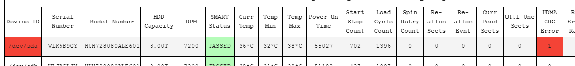

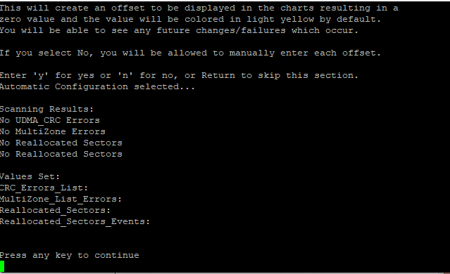

I am using Multi-Report v2.5 dtd:2023-11-26 (TrueNAS Scale 23.10.1.3). I have a drive that has 1 CRC error. I went into Advanced config to try and offset it. I keep getting error "fdisk: command not found". Any offsets I specify do not save and it shows No CRC errors found. How can I fix this?

NugentS
Apr 16, 2020
2,947
Can I suggest you post your config code snippet, in code blocks - so we can see what you have done
I asssume you are editing the config file and NOT the main script file
JDE1000
Sep 15, 2023
10
I just edited my post to include the config. hopefully I did the code blocks right. I am using the ./multi_report.sh -config
NugentS
Apr 16, 2020
2,947
After you create the config file using -config - you need to edit the multi_report_config.txt file in the same folder
joeschmuck
Old Man
May 28, 2011
10,996
The easy way would be to read the config file you posted, but I guess the easier way is to give it to you.
Edit your multi_report_config.txt file in a simple text editor and scroll down to the line: CRC_Errors_List=""
Change that line to: CRC_Errors_List="VLK5B9GY:1"
Note: The serial number must be exact or it will not match.
This bothers me and I will check into it. I'm curious if fdisk is not in the path anymore with the new SCALE release. It's very possible, which means other errors as well.
Edit: SCALE 23.10.0.1 works. In the process of upgrading to 23.10.1.3 (hope it works)

JDE1000
Sep 15, 2023
10

Thank you this worked. Just to advise what I had tried. I started a new config and when it asked to do auto error detection I said yes. It found no errors. Then I went back into config and hit K and got the Fdisk errors.

Thanks for posting that information. Not sure exactly what is going on here. I am unable to recreate the issue. It of course looks like the script cannot locate 'fdisk' and when you created a new config file, you may not have seen the error messages but I'm certain they happened, they are just piped to not display on the screen.
Question, where do you have the script located at? Does the path have a "space" character or other special symbol? I do think it's the location and/or privileges for when you are manually running the script. That is all I can think of as this kind of thing has caused strange problems. Most people like to place the script in the '/root' directory. I hear it solves a lot of permission issues.
But I'm glad it's working for you.

Thank you kind sir for the help. I'm not that familiar with linux commands so I placed this just in a working directory on my Truenas Scale (/mnt/Storage/jde1000).
