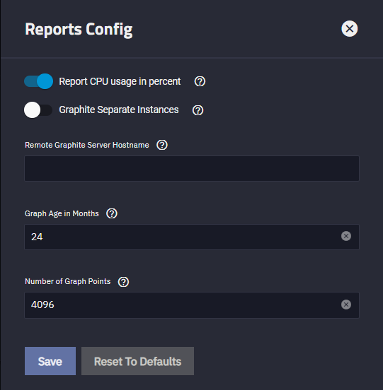

Under reports config TN says "Remote Graphite Server Hostname". Implying I should be using graphite which (at least in the container I have found seems to include a collector - graphiteapp/graphite-statsd). Although I think that TN uses graphite as that doesn't work for me in what I want to see

collectd is provided by TN is it not?
Is that not the bit configured by:
Patrick M. Hausen
Nov 25, 2013
7,776
Precisely. I was only referring to the fact that it is not the only source of metrics existing. And for some reason iX have decided to use the graphite plain text format exclusively. So you need to define a graphite plain text connector in influx. Because influx is much more convenient and manageable than graphite. Unfortunately there is no port of the 2.x branch to FreeBSD, yet. But that is not your concern if you are using SCALE.
"Graphite separate instances" is useful, just trust me and activate it - you will have a way easier life when building your graphs in grafana.
