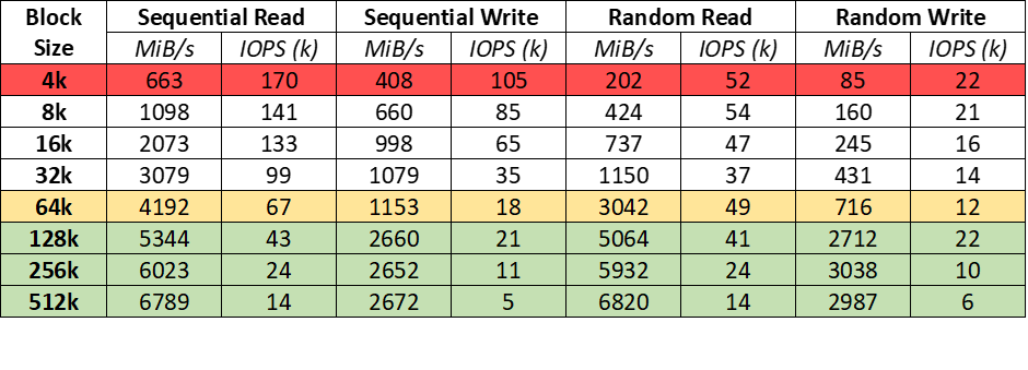

Now, here's my results:
Notes on the benchmarking:
  • File size = 4gb
  • Number of Jobs = 1 (single stream/operation)
  • IO Depth = 1 (ie. a single stream/operation)
  • Time = 30s
  • This should be a "worst case" scenario benchmark... 4k random read/write increases dramatically with more jobs/IO depth (ie. 1000-1500 MiB/s 4k random write, with say, IOdepth = 16 and Jobs = 16)
Based on the above, you can see the 4k performance is horrendously bad (for sequential and random) on my setup... but I would think most of the data on my NAS wouldn't be affected by this (photos; movies; documents etc.... most things are significantly larger than 4k!). Things only seem to really improve around the 128k block size mark... which is even more confusing, as that's the default ZFS record size.
I would have thought a scrub would be 128k sequential reads (mostly, given the record size), along with the odd random write if necessary? Seems strange the performance was so slow for the scrub...
