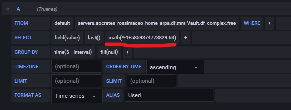

Well, somehow the measurement of .df_complex.free for my main pool is excatly what the GUI is telling me is free of my main pool. So I can deduct used space via: total (I already know) - free = used.
ragametal
May 4, 2021
188
I have the same results as you on the "free" space but, how do you calculate the "Total"? I mean, i know that 100% of the disk space is not usable so the (disk space) x (# of disks) is not equal to "Pool total space".
Care to expand on how you did it?
I'm not criticizing i honestly want to know for my own education.
The reason for calculating the total is to use it to calculate the "used space" per your suggestion.

You can calculate raw capacity easily. number of disks * disk space = total pool space. Of course there's deductibles with zfs.
I used this calculator to calculate my pools total. https://wintelguy.com/zfs-calc.pl
For me a ZPool with Raid-Z2 of 6 disks each 4 TB, gives a raw total of 24 TB and as per the calculator a usable space of 15.94 (I rounded up to 16 TB for grafana total).
This is a great workaround.
With the actual size of the pool I was able to calculate the "Used" space based on the "Free" space.
Now, @Patrick M. Hausen , I admit that using a constant like this is not ideal as it will require manual intervention per Pool, but i really don't feel confortable adding or altering files to the truenas base system. That is why i like to experiment inside jails.
