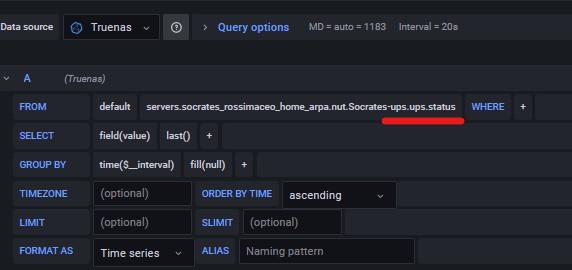

I set a cronjob in Truenas to run this script every minute and now the UPS status is available in grafana.
In grafana just create a "Stat" panel and look for the field that ends in "ups.status"

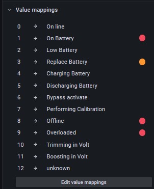

However, this will only give you a numeric value. In order to get the actual status, we need to add some "Value Mappings" as follows:

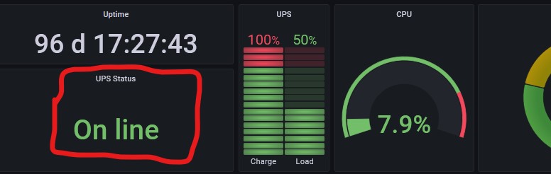

The end result is a panel with the UPS status
