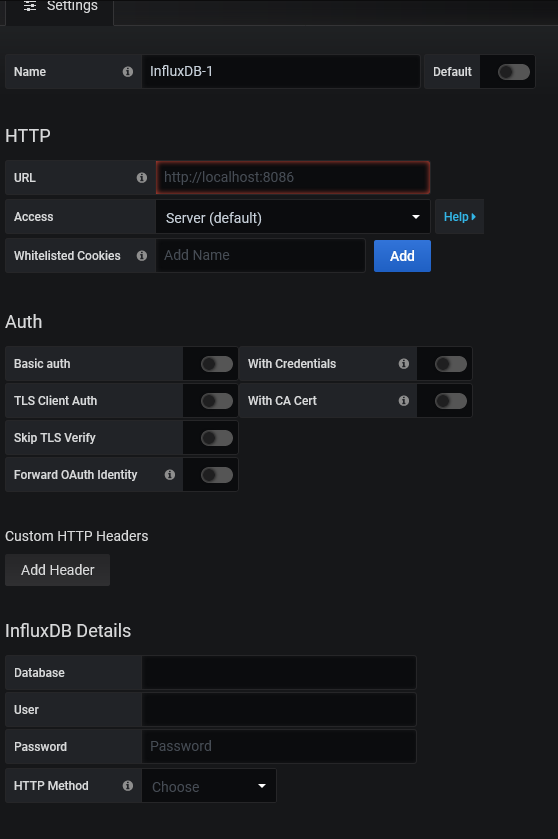

Thanks, but what to change there? How do I add InfluxDB as a data source or what do I need to setup before the plugin truly works? I tried localhost:8088 with the user/pass in the "post install notes" but it wont connect "Network Error: Bad Gateway(502)"
9,703
ocalhost:8088
Where did you try that from? usually I would expect you to do that from a web browser, so not on in the plugin jail, which would mean that localhost isn't the right address.
Jul 21, 2020
5
Yes in the Grafana web UI. The TrueNAS plugin comes with both Grafana and InfluxDB, but they are not connected by default. (There are no datasets set in Grafana). I assumed since InfluxDB and Grafana were on the same iocage (plugin), localhost would be the right choice
9,703
OK, now I'm with you.
Have a look here:
A few steps above the screenshots, it refers to creating a database... you must do that or you can't connect.
Jul 21, 2020
5
Thank you but I hoped for a more plug and play / one click installation from this plugin.
But I guess there is no way around manually setting it up. But Thank you anyway

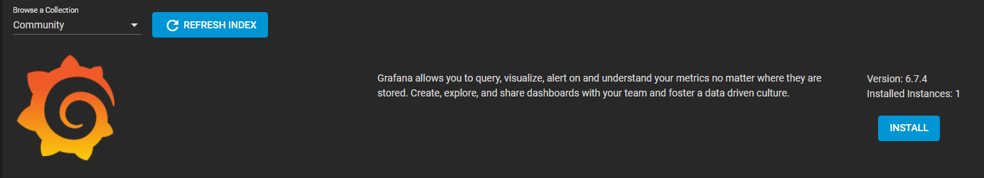

Yes Lightningblade it was a bit of a setup. Just looking for them to update the Grafana Version or how to update to Grafana 7 within the plugin.
9,703
iocage console grafana
pkg upgrade
pkg install grafana7 (need to say yes a few times, you should see it will replace v6 with v7 and will re-use the same grafana user)
exit
iocage restart grafana
