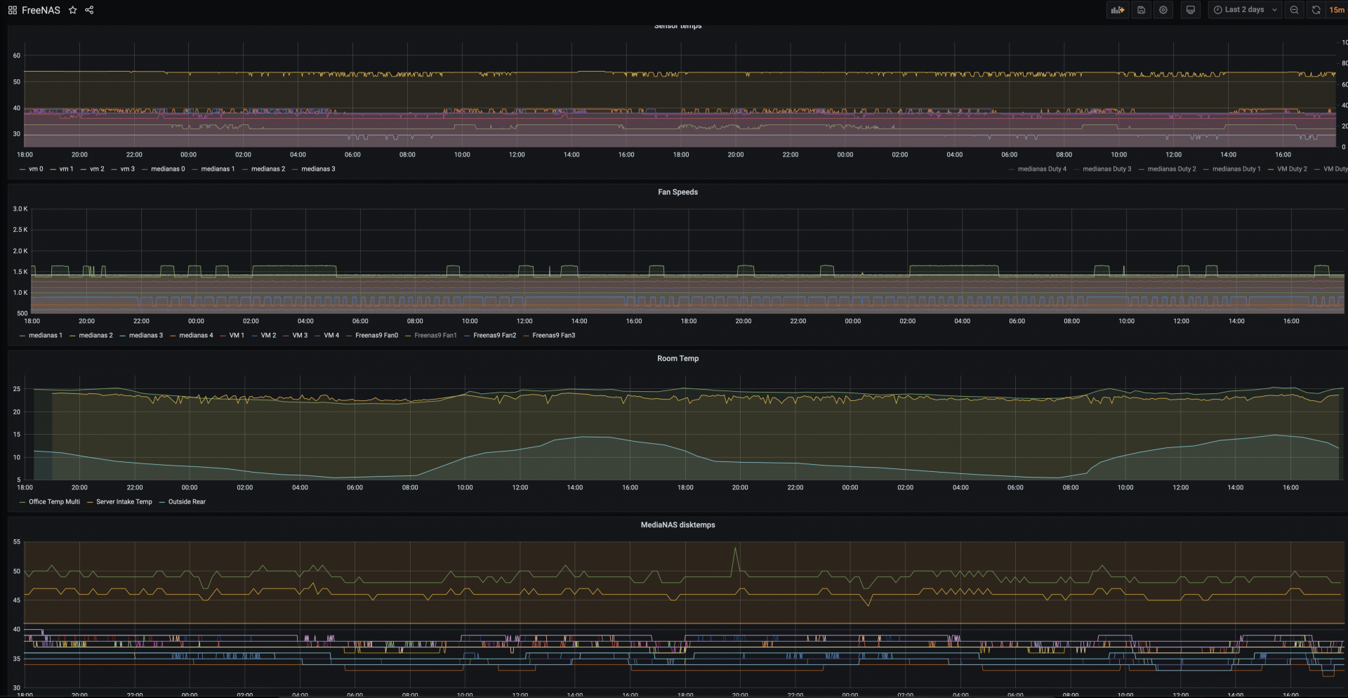

My script isn't using TrueNAS' connection to graphite, I'm just pushing individual values via constructed URL, which I would be very surprised to find not working.
Could you post a screenshot of what you actually see please?
Is that what you were looking for?
