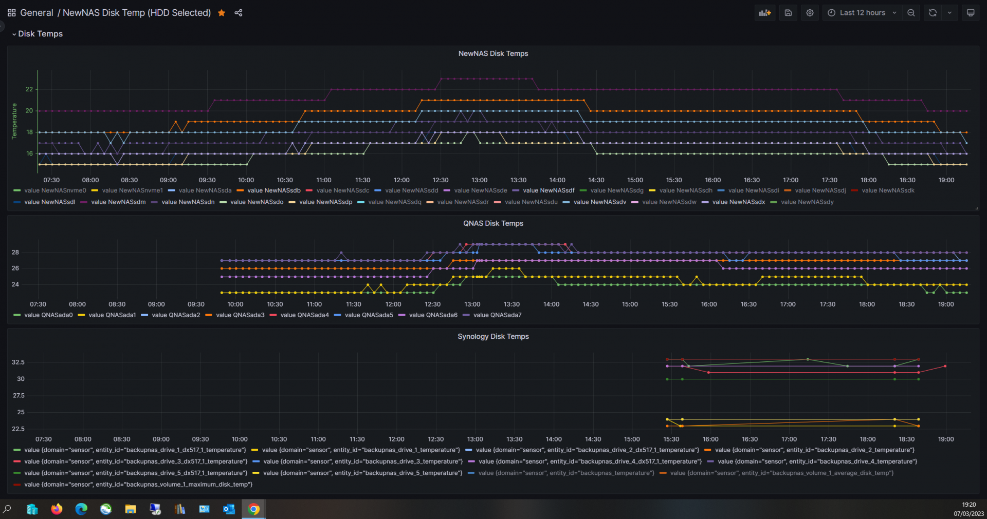

And this inspired me (now that I am an expert (NOT)) to install home assistant on my Synology and push those details into influxdb and measure the Synology disk temps as well. Might have a play with the rest of home assistant later, maybe
Which just works
NugentS
Apr 16, 2020
2,947
Yay - now I just have to wait for Summer to watch my drives melt
NugentS
Apr 16, 2020
2,947
except that, as it turns out the homeassistant doesn't seem to be entirely reliable when it comes to gathering temp stats. Hmmm, perl is installed on the synology - I wonder if a certain script that works on scale would work on Synology.......

Turns out that HomeAssistant only posts data to influxdb on a change - not entirely what I was looking for. Apparently it might be possible to force a regular update - but its all gobledegook to me
