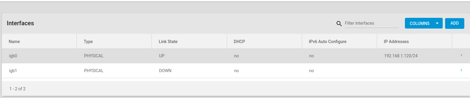

I don't have a "bridge0" interface in the TrueNAS Core GUI. It only exists when checking with "ifconfig" in the command-line.

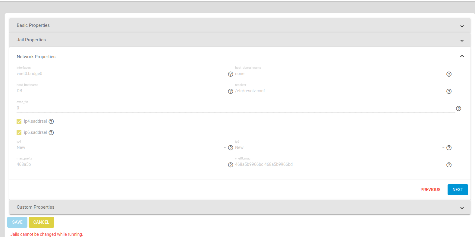

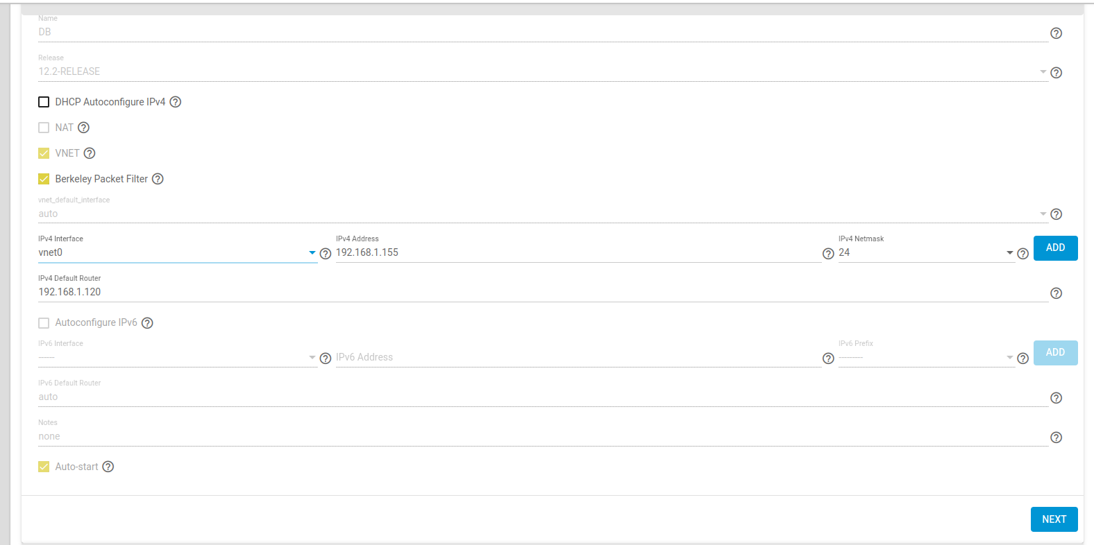

In my case, the bridge is configured per each jail.
For example, a jail will use re0 as the vnet_default_interface, and then under Network Properties the interfaces is vnet0:bridge0
In summary:
  • Before creating any jails, the TrueNAS Core GUI shows the physical network cards that you can configure for the server itself
  • No need to manually create a bridge interface (i.e, "bridge0") in the GUI
  • When you create and configure a jail to use VNET, and assign it a vnet_default_interface (i.e, "re0"), it should automatically create a bridge interface (which will still not show up in the GUI; only in the command-line)
  • You can then confirm this by checking the jail's Network Properties and even using "ifconfig" to check in an SSH session

igb0 is missing from the bridge interface. And your configuration is invalid even with U5.2. The IP address must be on the bridge0, not on igb0.
- reboot with all jails autostart disabled
- create an interface of type bridge named bridge0
- add igb0 as the only member interface
- remove the IP address from igb0, instead put "up" into the options field
- put the IP address on bridge0
- test and save - you should increase the timeout from 60 to e.g. 300 seconds before clicking "test", then clear the ARP cache of your desktop system

- vnet_default_interface: none
The rest looks good. Your jails should work afterwards.
If that worked, then for each jail:
