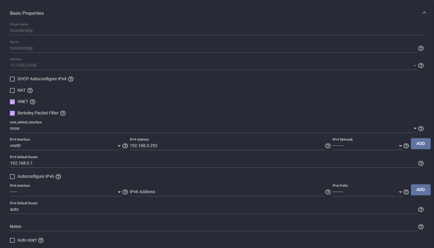

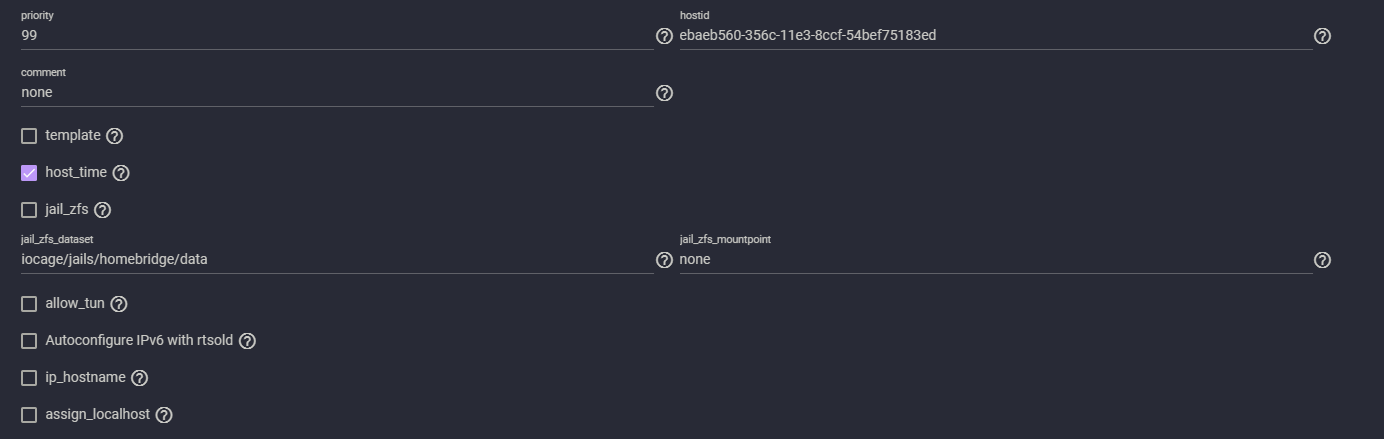

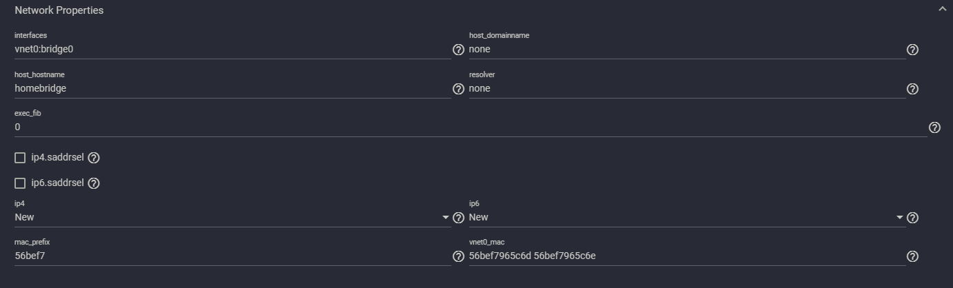

What does that mean? Additionally, here are the config pages for one of the jails. It could be likely I just messed up or misinterpreted some setting.Remove IP address from re0 only putting "up" into the options field. Apply IP address to bridge0 interface.
