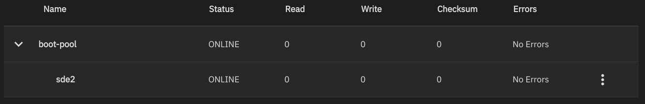

After that I tried to attach the disk to the bot-pool and got:
 FAILED
[EZFS_BADTARGET] cannot attach /dev/sdf2 to /dev/sde2: can only attach to mirrors and top-level disks

Which seems very strange, but is somewhat consistent as I get the ... menu with the replace/attach actions only on the existing disk and not on the pool itself. So I used it from there. I would have expected to have the attach action on the pool and the replace action on the disk.
Rebooting does not change anything.

Not sure what to do now. The GUI looks strange to me.
