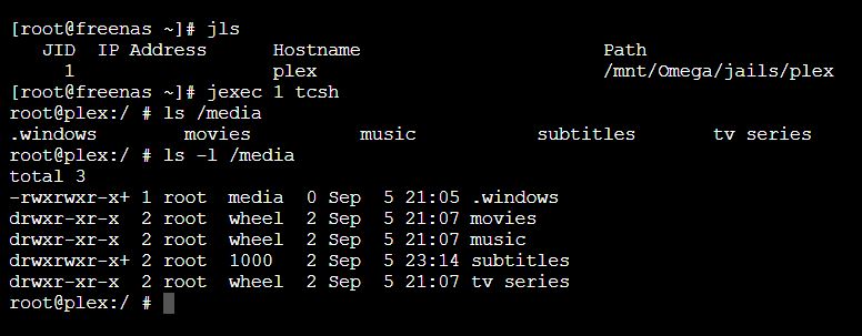

I simply cannot give the correct permissions to plex...
I have been reading posts for the last two days, and nothing works!
I have tried to set permissions in plex and also changed a lot of permissions in freenas, but without it resulting in access to the files...

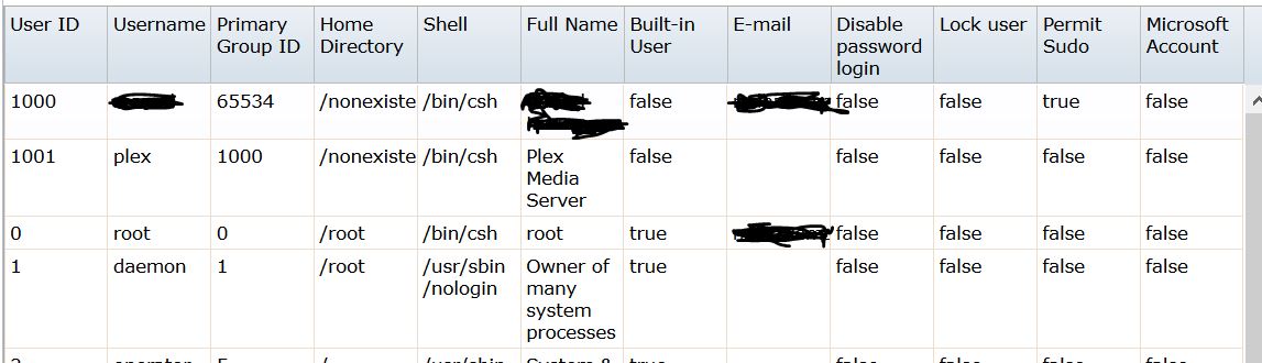

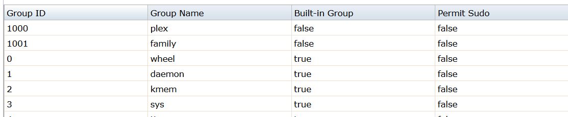

I ended up setting all my permissions on all volumes in freenas to user:root and group:wheel - should this be changed? Capture3.JPG Capture4.JPG
---and have, what can be seen in the attached file, in plex...
Could someone help?
Is there a step-by-step tutorial for setting up user permissions for plex somewhere?

I’m not sure about any peculiarity with Plex but in general a service in FreeBSD is started with a script. https://www.freebsd.org/doc/en/books/handbook/configtuning-rcd.html
That script would name the user used to run the service. That user need to be either changed to a user with access or the default user needs to be given access. Personally I use groups, giving all service uses memberships in the groups they need for content access when content is shared between services. If it’s only internal content like a reverse proxy I set that up so it’s isolted from anything else, even if the device is in a jail.
root:wheel is a terrible practice.. FreeNAS has a default “media” group. I suggest you use that or make your own. Just make sure that the group has the same GID in both FreeNAS and the jail. It’s really simple.
