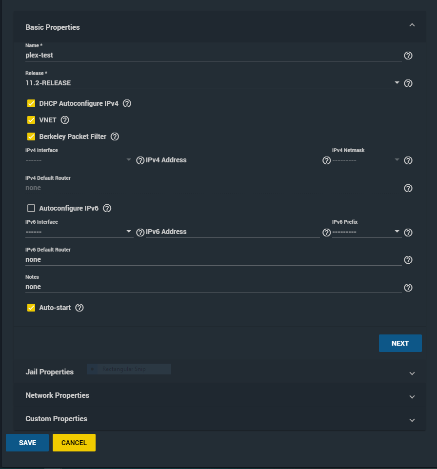

ps auxw | grep -i plex
See if the process is running, the output from starting it says it's probably running but we are not sure.
Also provide the hardware specs and are you using vnet|vimage

then on the vnet|vimage i am not sure
