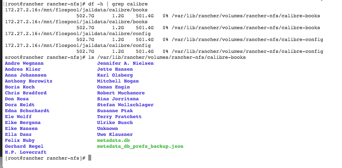

Ok, so this finally worked. For my calibre-server container I did the following (a running Rancher VM as a prerequisite).

- export=/mnt/flospool/jaildata/calibre/books (note the full path including the ´books` directory defined earlier)
- host=172.27.2.16 (Important: The ´export` driveOpt just does not work without ´host´ defined! ´host` is not inherited from the NFS_SERVER as one would expect. This took me hours ...)
- onRemove=retain (I prefer to keep the data in the directory should the container be removed.)

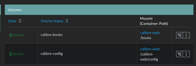

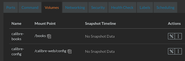

After this I added the container. I'm using the technosoft2000/calibre-web container (https://hub.docker.com/r/technosoft2000/calibre-web/).
Definitions include:
- Volumes calibre-books:/books and calibre-config:/calibre-web/config

Now I started the container. In the browser the new calibre server is available with the IP address of the Rancher VM and the port exposed in the container, in my case: http://172.27.2.35:8083.
