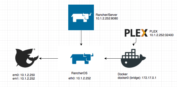

Diagram:
  • My FreeNAS box has 2 x NICs, the one associated with my virtualization is em1 (10.1.2.252)
  • RancherOS sits on em1
  • Rancher/Server is an interface for managing a docker cluster! So many large scale companies actually use it
  • Docker sits inside RancherOS and is setup with a host network
  • UPDATE - The official PLEX documentation recommends the host network, so I've changed to that. The host networking uses the IP address of the host running docker such that a container's networking appears to be the host rather than separate.
  • If you must use bridge - Any container that sits inside docker and if it's on the bridge network is accessed via an internal NAT by its port. It can work but the setup is slightly more complex.

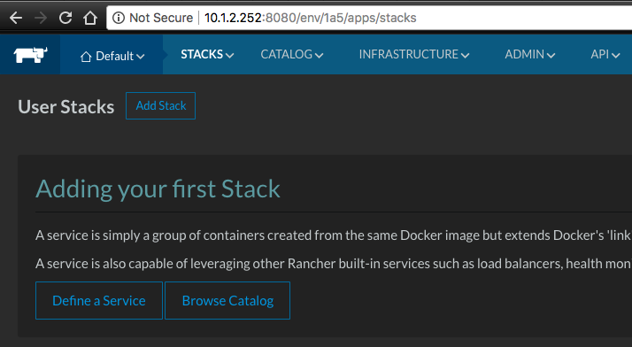

Continue with the guide and access your UI by navigating to IP:8080

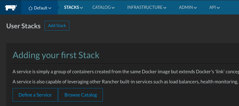

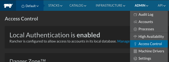

2. Security
Many ways of limiting access. The easiest is Local Authentication
Head over to ADMIN > Access Control > Add Account
Add whichever you like and get rid of the Red exclamation that is next to ADMIN

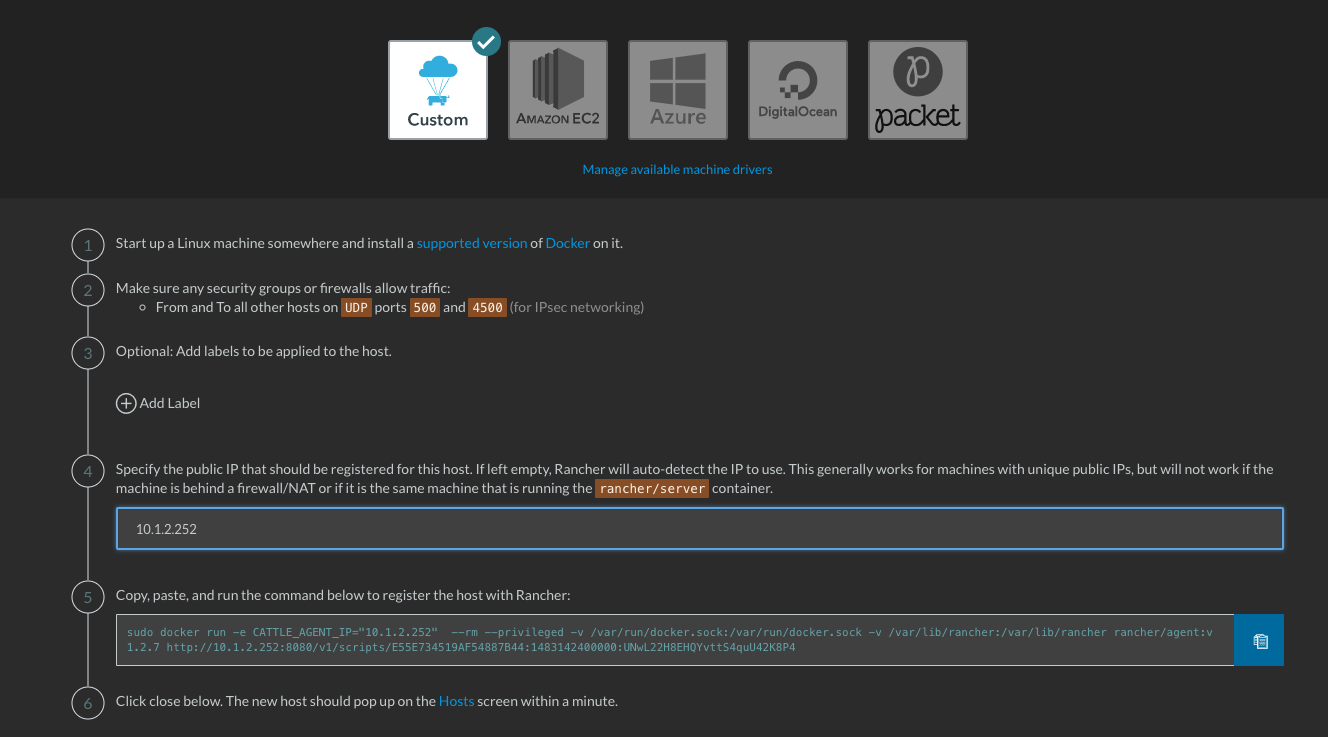

3. Add a Host
As mentioned, Rancher is a way of managing a Docker cluster or cattle as they call it. So before beginning to add containers we need to add a host.
INFRASTRUCTURE > Hosts > Add Host
Fill in your IP in number 4 and that will update field 5. Copy the code by pressing the blue button on the end of field 5. Head back to your terminal which should still be logged in to your RancherOS machine and paste and run that command.

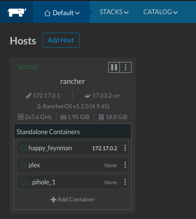

Almost immediately you should see a Host on the Infrastructure > Hosts Screen within Rancher UI

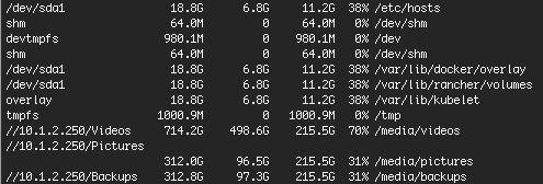

4 Mounting Volume - New Method
So your containers will need access to your Volumes within FreeNAS. The way we do this is by:
  • Creating a share on FreeNAS (I've got some SMB/CIFS shares)
  • Mounting shares to RancherOS
  • containers in Docker can map to those mounted volumes within RancherOS
Create a plex user within FreeNAS
  • Our example uses username = plex and password = plexpassword. Replace these with your own values
  • give it READ access to where your media is
  • give it WRITE access to where you want PLEX to store it's config and transcode folders
The Way to mount the storage is:
  1. Create a YAML file
  2. Merge it with the config
  3. Restart RancherOS
When ready create a file somewhere called mount.yaml:
vi mount.yaml
Press i to get into insert mode
Add the following lines:
mounts:
- - //10.1.2.250/Videos
  - /media/videos
  - cifs
  - username=plex,password=plexpassword,iocharset=utf8,_netdev
- - //10.1.2.250/Pictures
  - /media/pictures
  - cifs
- - //10.1.2.250/Backups
  - /media/backups
  - cifs
Replace the directories / IP with your own. If I look at the code above:
  • I'm mapping the Videos share on FreeNAS (10.1.2.250)
  • to the /media/videos directory in my host (RancherOS)
  • using the CIFS protocol / driver
  • with the username of the share being plex
  • and the password of the share being plexpassword
  • etc
Cool story right?
Press ESC then :x to save and exit
Now run:
sudo ros config merge -i mount.yaml
Replace with your share(s)IP and credentials ofcourse.
Now Storage will persist even on reboot.
Be sure to reboot RancherOS for your volumes to show up.
you should see your shares mounted to the host (RancherOS) by typing:
df -h

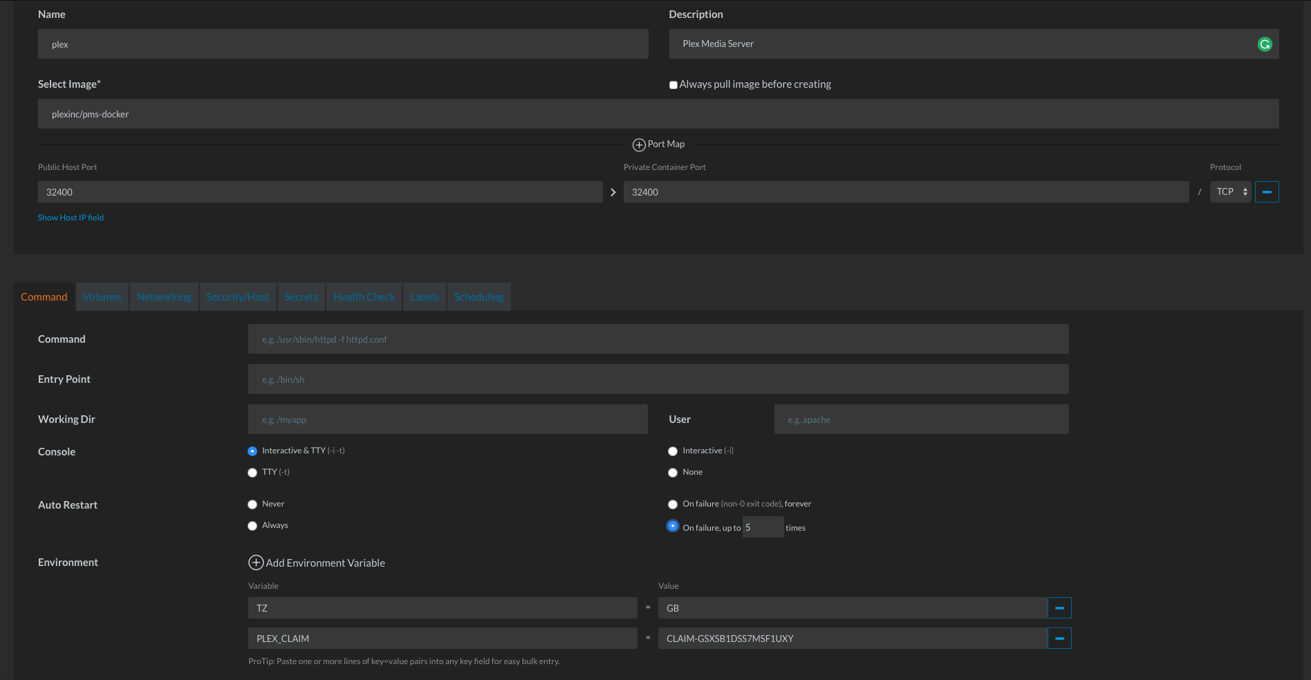

Enter the following:
  • Name - plex (or whatever you like)
  • Description - optional but nice
  • Select Image - plexinc/pms-docker
Click the Plus Button under Port Map and Map the Port:
  • 32400 to 32400
This forward the requests sent to the host on 32400 to the 32400 port in the container
Come down to the Command Tab
Click the plus button to add Environment Variables:
TZ - Timezone
PLEX_CLAIM - A claim token for signing in which can be obtained from https://www.plex.tv/claim/

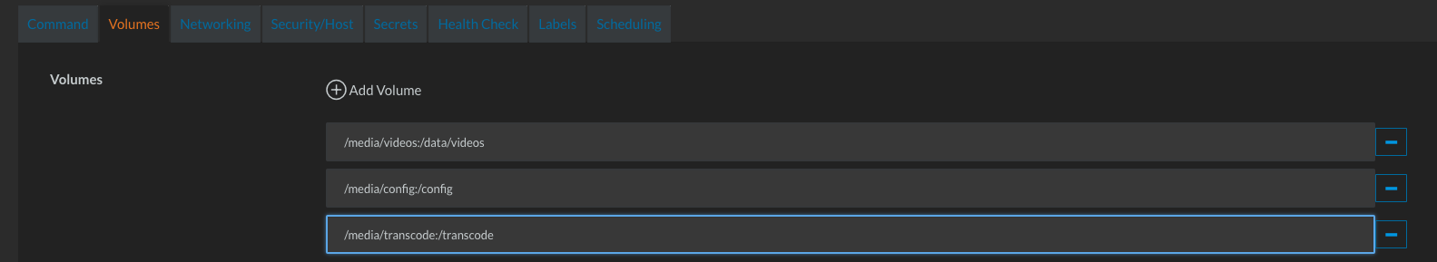

Go to the Volumes Tab
And map the Volumes like so:
These are the minimum ones you need
  • /data - where does your media exist? We mapped this in the steps above
  • /config - where PLEX config lives
  • /transcode - where PLEX transcode files live

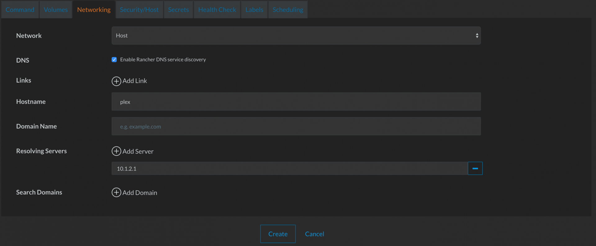

**UPDATED**
Go to the Networking Tab and set:
  • Network - host
  • DNS - Enable Rancher DNS service discovery
  • Hostname - Whatever you'd like the hostname to be (ensure this hostname doesn't already exist on your network)
  • Resolving Servers - Your router / DNS server
Click Create!!!!!!!!!!

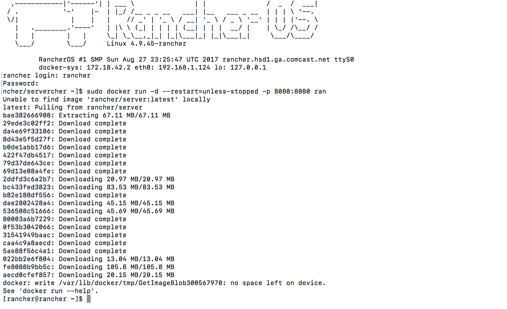

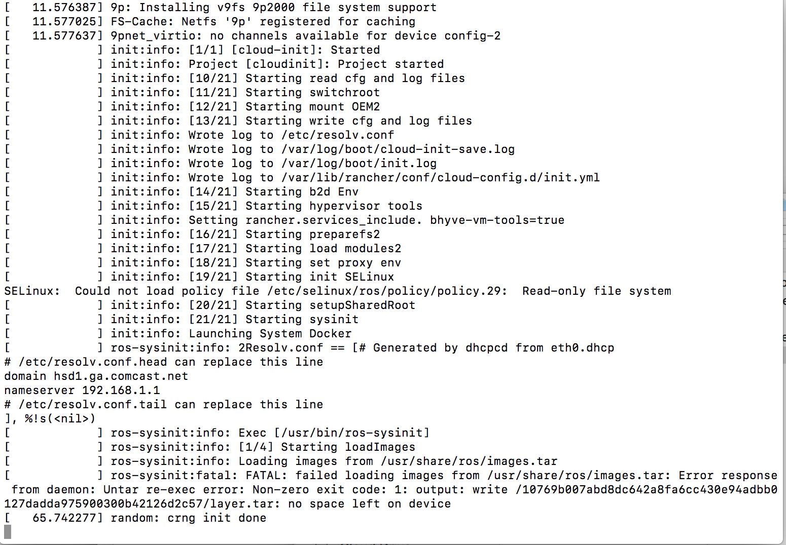

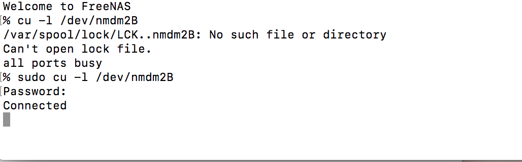

help! I am getting stuck at the first step itself. see screenshot. after doing a cu, it says connected but doesn't go beyond that.

Varun Chugh
Dec 15, 2015
38
Hit the return key a few times.
hey @Yusuf Limalia tried doing that more than a few times :) to no effect. when I check the dataset, I dont see any images. Could it be that the img didnt download? The VM says its running. I tried creating more VMs but the output is the same.
Is there any place where freenas downloads the VM template or something? Would try deleting that and creating the VM again.
Yusuf Limalia
Apr 5, 2016
234
Check this post:
https://forums.freenas.org/index.php?threads/freenas-11-1-rancher-server-installation-failed.59898/

hello yusuf
step 4 add a host
[rancher@rancher ~]$ sudo docker run -e CATTLE_HOST_LABELS='host4='  --rm --privileged -v /var/run/docker.sock:/var/run/docker.sock -v /var/lib/rancher:/var/lib/rancher rancher/agent:v1.2.7 https://10.147.42.130:8080/v1/scripts/49F7E6AE249F00566EB6:1483142400000:uowA1LfGFxULopYkFMVTlYdEko
6
INFO: Running Agent Registration Process, CATTLE_URL=https://10.147.42.130:8080/v1
INFO: Attempting to connect to: https://10.147.42.130:8080/v1
ERROR: https://10.147.42.130:8080/v1 is not accessible (server certificate verification failed. CAfile: /etc/ssl/certs/ca-certificates.crt CRLfile: none)
Varun Chugh
Dec 15, 2015
38
I did get past this. Now I am stuck at 'no space left on disk'. But I have GBs of space on the disk. Any idea? Sorry for the trouble. all attached the screenshot.
and one more image for reference when I try and install the Rancher system I get the same no space left error. Please help!
