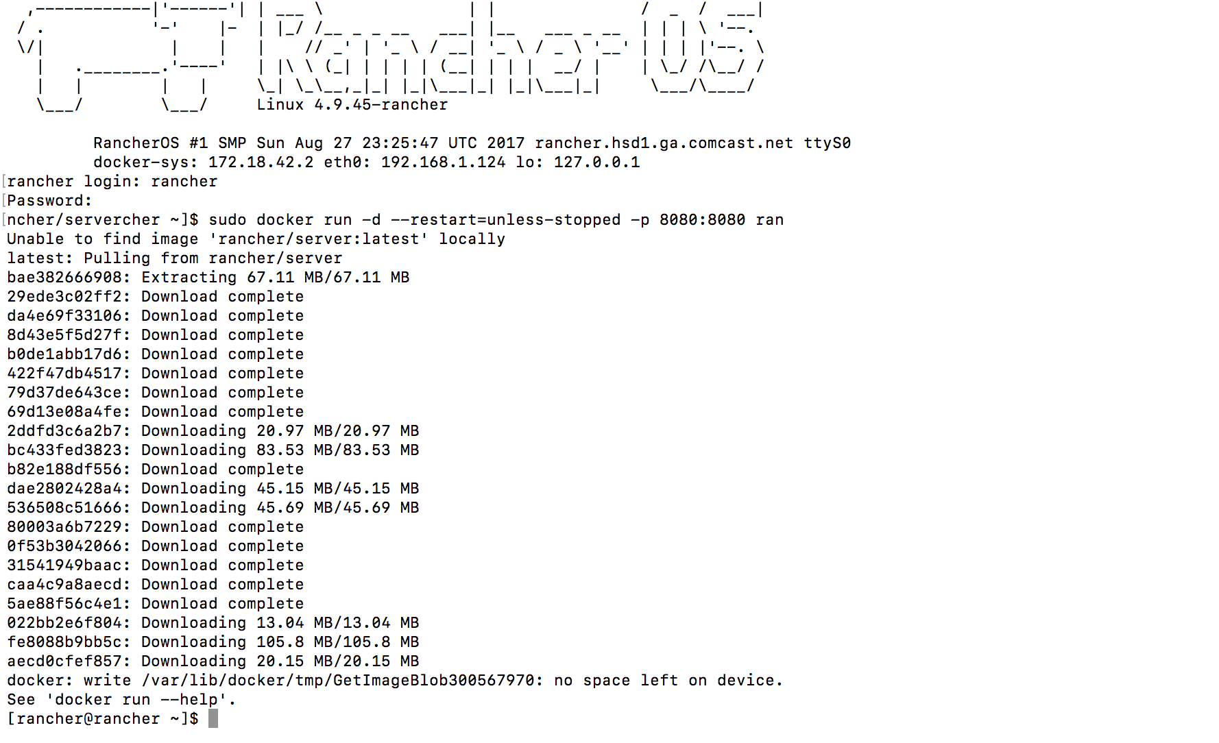

yeah, that helped! thanks :) any idea into the no space left issue? See attached screenshot.

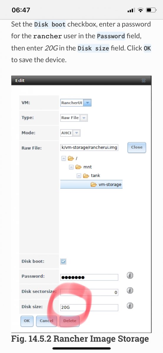

I did get past this. Now I am stuck at 'no space left on disk'. But I have GBs of space on the disk. Any idea? Sorry for the trouble. all attached the screenshot.
Did you set your VMs disk size to 20G? I had this error when I didn’t do that. This step is in the official docs/ step 1 of my tutorial
