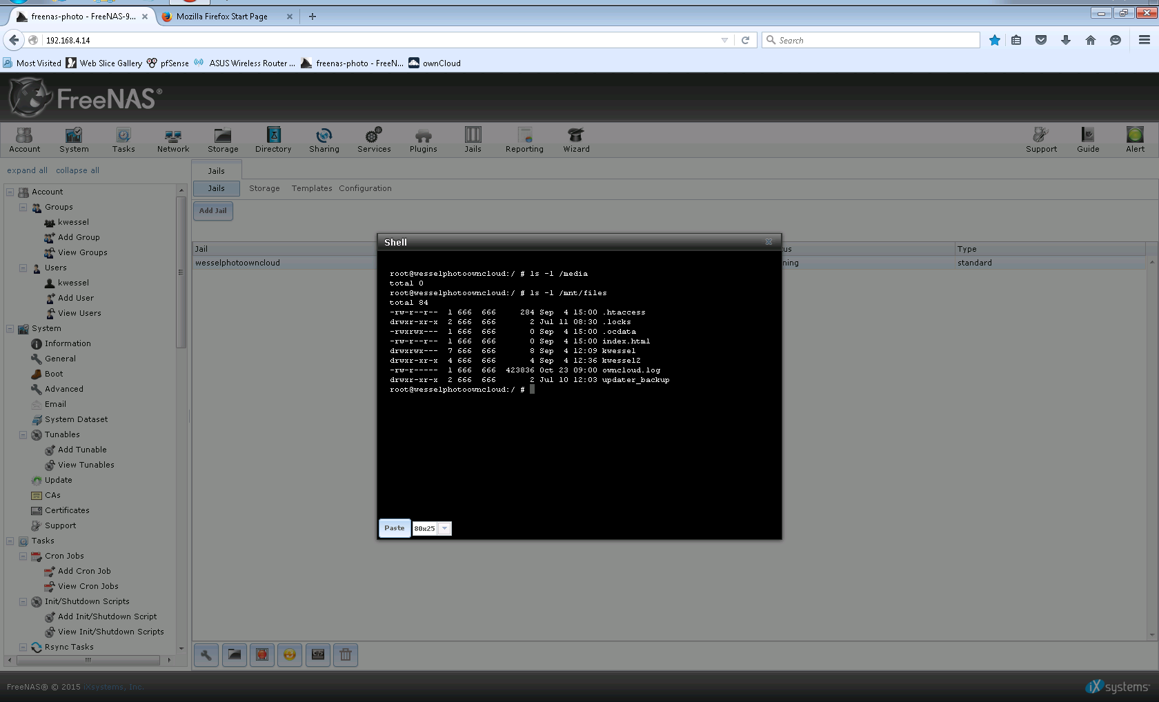

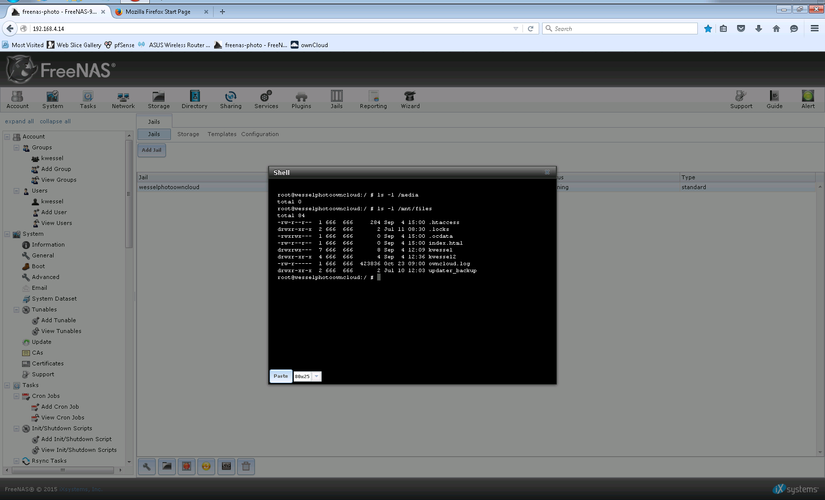

How do I change it back to www and why would this happen?
chown -R www:www /mnt/files
you can check if that UID corresponds to a user in your FreeNAS, since it shows a number in the jail it doesn't correspond to a jail user.
I'm guessing you or someone changed the owner on the FreeNAS Storage tab.
you may want to double check your db dataset didnt get changed from it's user 'mysql' (UID 88).
ls -l /var/mysql

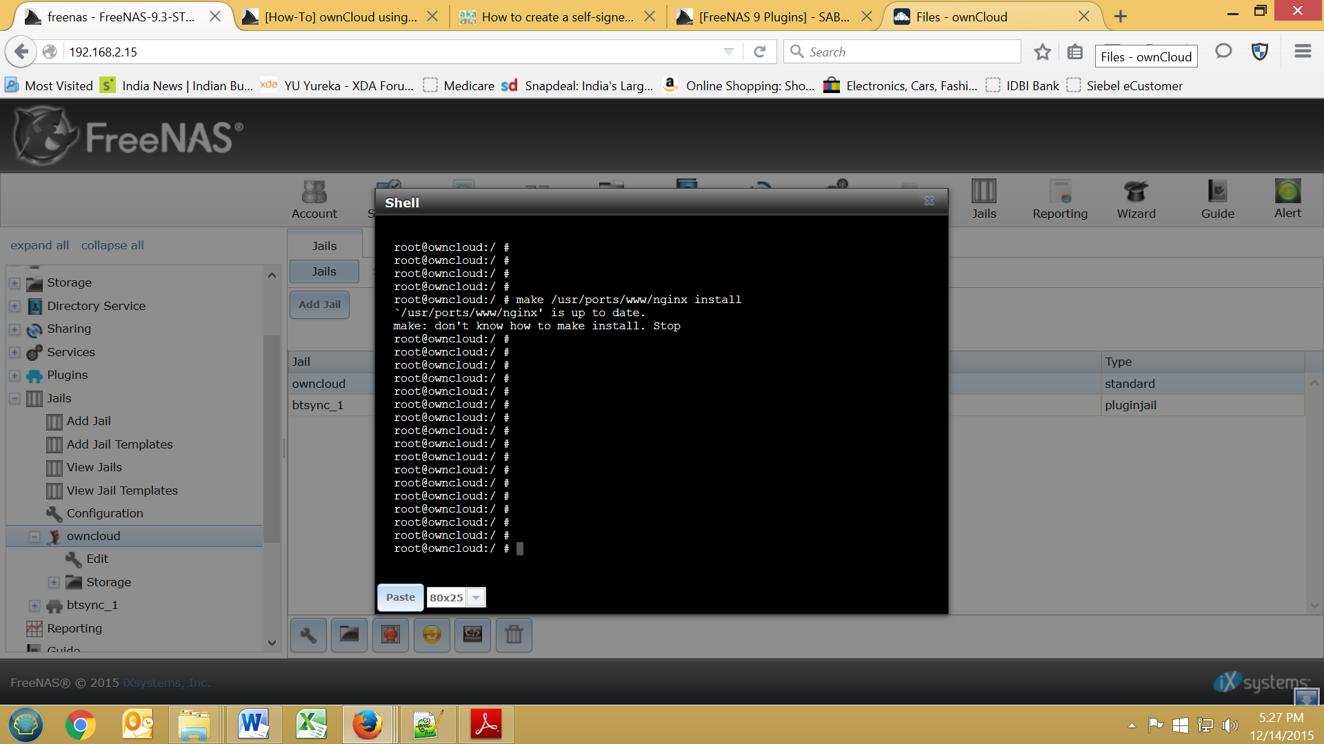

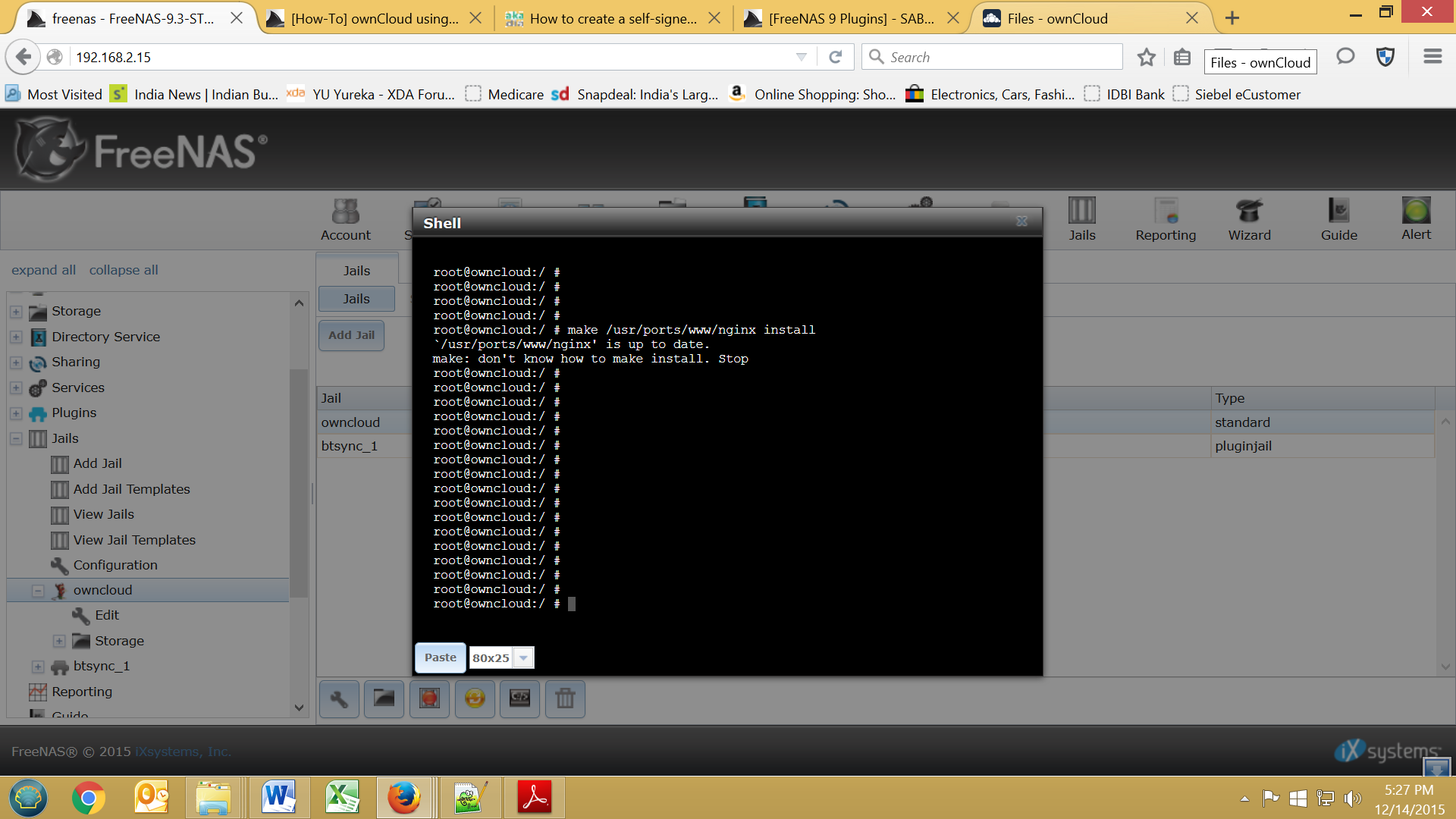

I have been using owncloud using the tutorial of Joshua without ssl. Now I wanted to have ssl. So I tried to follow the patch of cyberJock. But I am getting a error at the make /usr/ports/www/nginx install .
Please help.
Please help.
something's wrong with that command you're running. either 'cd' to the directory and run "make install". or that path needs to be passed as a parameter to the -C flag
Thanks for four help. I manually went to the directory as per your advice and was able to complete make install and the subsequent steps as mentioned in the cyberjocks tutorial to create the certificates etc., Everything went on well without any errors.
