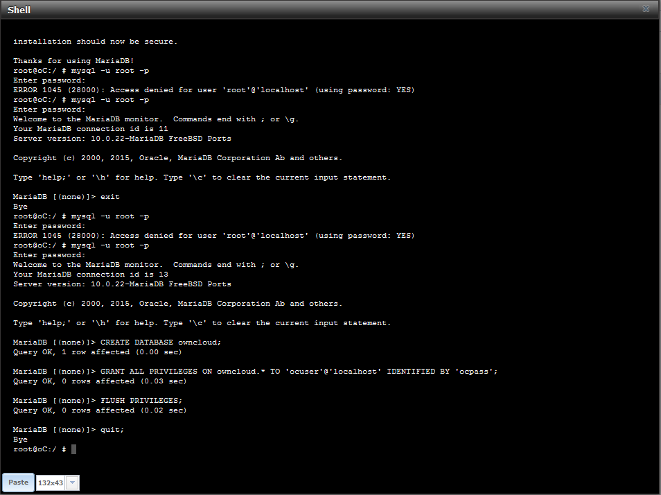

This last time I have found that when I get to the end and try to run: "mysql -u root -p"; it returns an error.
It will not let me proceed. Also; of all the times I have recently tried this; I can never go back to the Freenas Web GUI storage tab and see a user or group that can be assigned to the db dataset called "mysql".

Can you show an output of the error? Did mysql start in the "service mysql-server start" step?
I've said this to you before, you don't need to worry about this. Mysql's init script sets the permission for you.

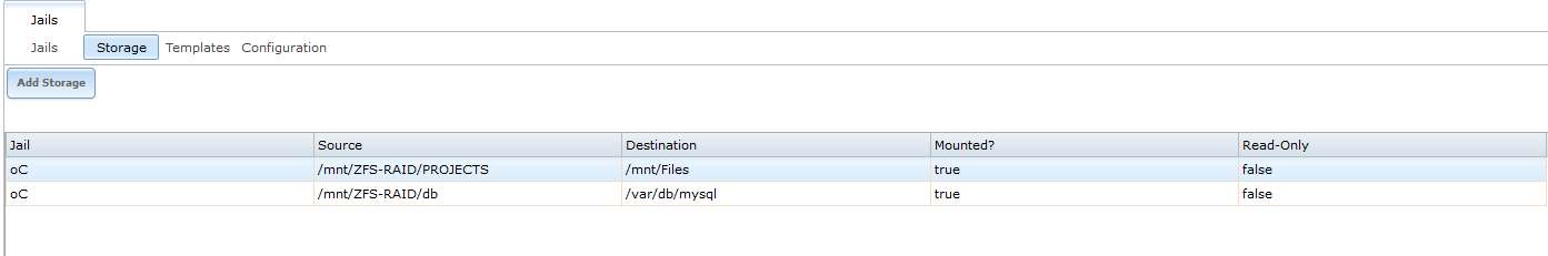

mcolinp
Jan 30, 2013
84
Well, I couldn't resist . . .

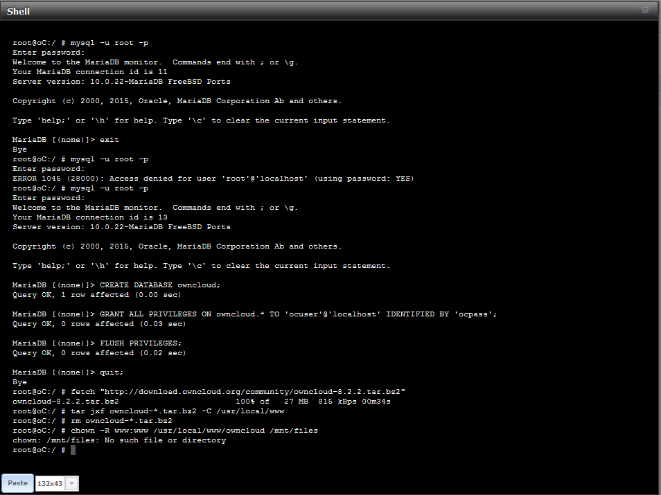

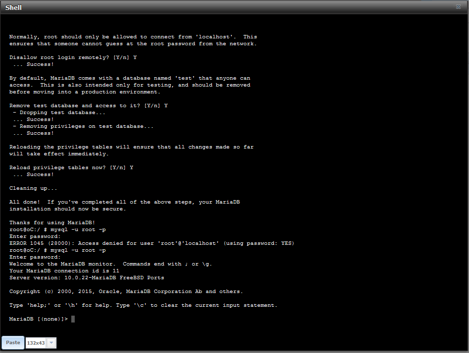

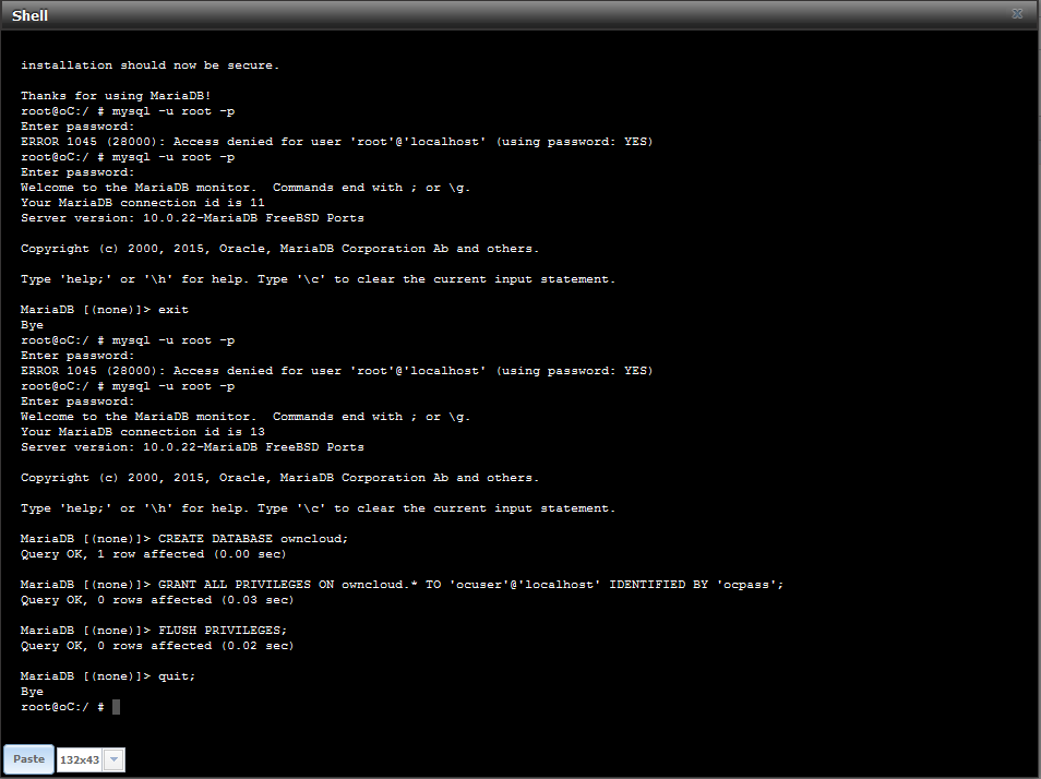

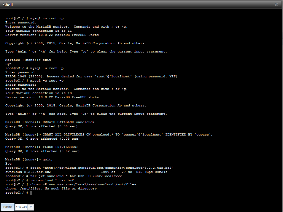

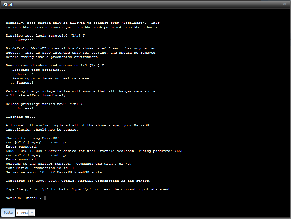

rsquared
Nov 17, 2015
81
Unlike Windows, UNIX based operating systems are case sensitive. Your last shell command failed on /mnt/files because, according to your last image, you've added it to the jail as /mnt/Files.

Aha!, It's typical that I get stumbled by the most insignificant details in relation to the bigger scheme of things. Thank You!
I will give it a shot later tonight.
mcolinp
Jan 30, 2013
84
nice catch @rsquared
was something still not working? I'm not sure what you're trying to show with all these screenshots?
I simply took multiple screen-shots leading up to where I typically fail to proceed. (So that you could see the lead-up to the potential issue.) I included the jails storage screen-shot as well to establish a complete picture of my setup fro diagnosis.
Thanks for your attention and assistance. It's much appreciated!

I carefully re-did the last part where it was pointed out that I had an error in file path (Case-Sensitive). This did not fix the whole problem. I carefully went back and double checked all the config files, etc; and no matter what I end up with a 404 nginx error when I try to load the ip address/owncloud in a browser.
