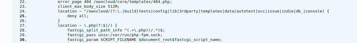

Check the attached part of your /usr/local/etc/nginx/nginx.conf
Specifically lines 24-26

I suggest you remove the /data location block (lines 78-82)
and replace your line 61 with " location ~ ^/(?:\.|build|tests|config|lib|3rdparty|templates|data|autotest|occ|issue|indie|db_|console) {"
