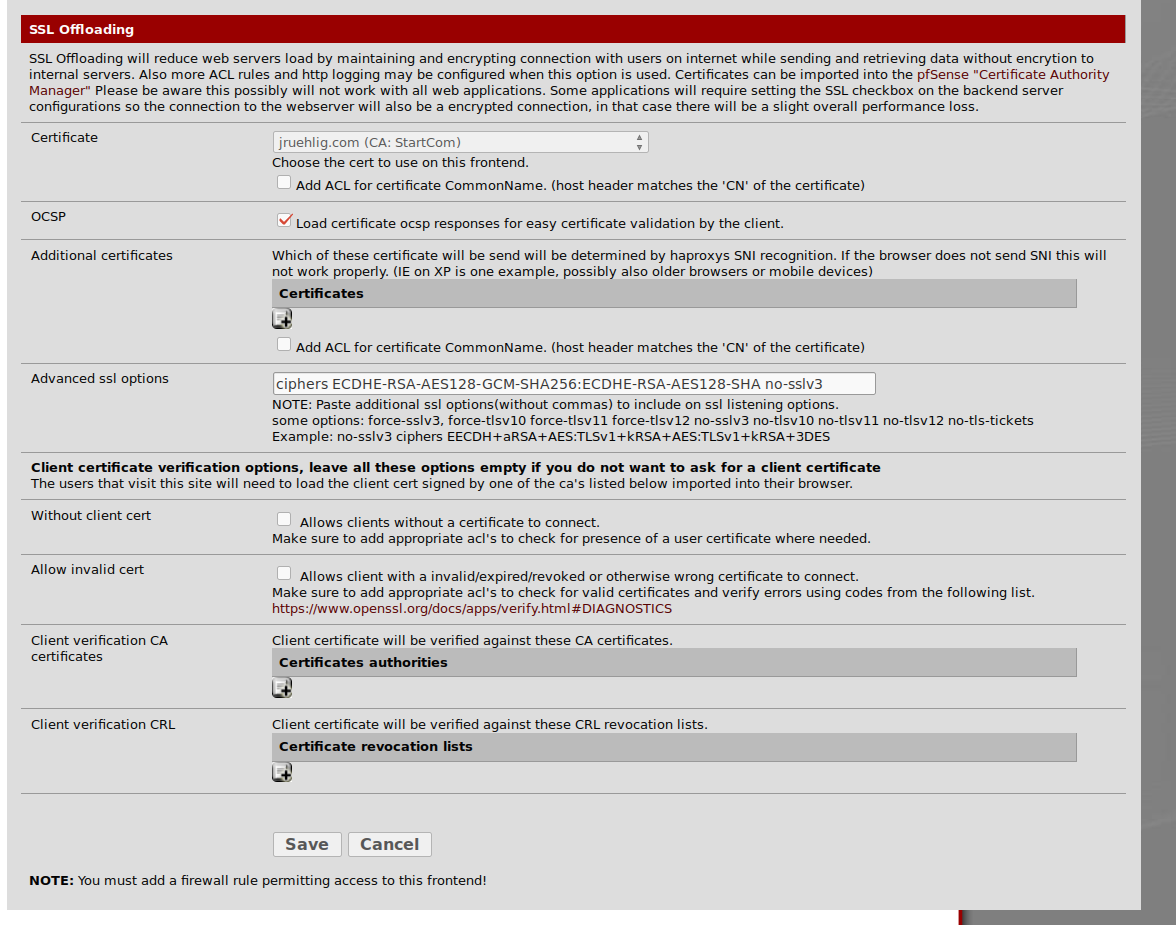

I kept going and I'm stuck on the last 3 steps, I don't see where those options are on the 'Frondend" tab....
View attachment 9091 View attachment 9092
EDIT +++++++++++++++++++++++++++++++++++++

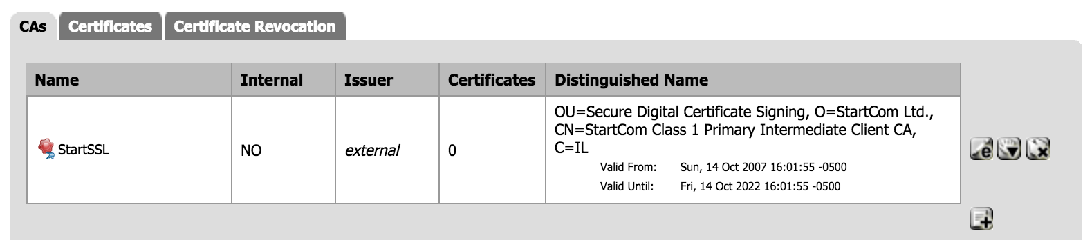

So there is a "Template" tab, that had the the frontend and bacnend temapltes for Startcom SSL...so I used that and i can see those options, however after selecting the Created CAs, i get the following errors...
Errors found while starting haproxy
[ALERT] 297/205335 (98765) : parsing [/var/etc/haproxy_test/haproxy.cfg:10] : 'bind 73.237.25.197:443' : unable to load SSL private key from PEM file '/var/etc/haproxy_test/HAProxy_stats_ssl_frontend.pem'.
[ALERT] 297/205335 (98765) : Error(s) found in configuration file : /var/etc/haproxy_test/haproxy.cfg
[ALERT] 297/205335 (98765) : Proxy 'HAProxy_stats_ssl_frontend': no SSL certificate specified for bind '73.237.25.197:443' at [/var/etc/haproxy_test/haproxy.cfg:10] (use 'crt').
[ALERT] 297/205335 (98765) : Fatal errors found in configuration.

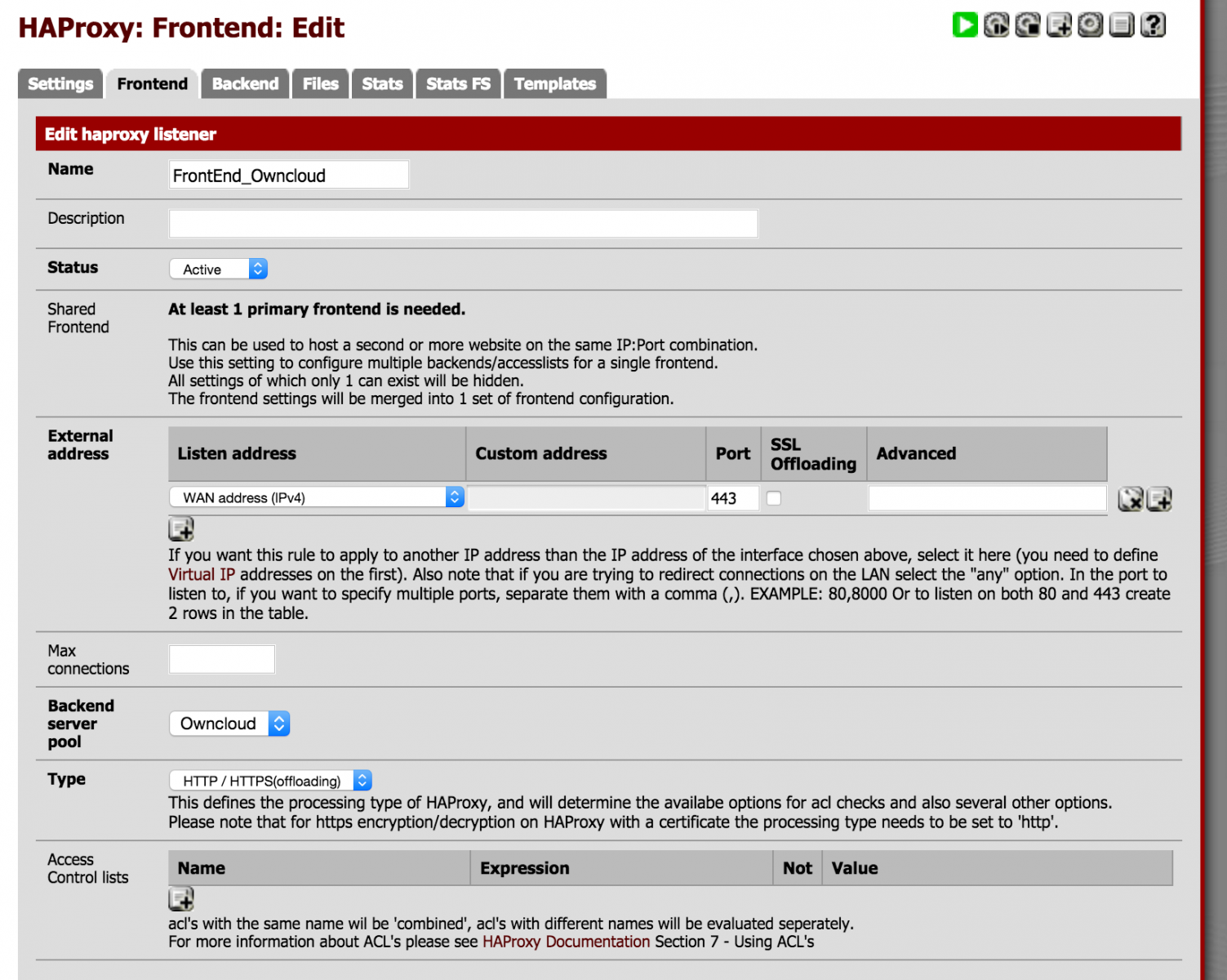

Here's the bottom of my frontend tab
Thank you, I tried everything and I cannot saved the changes.
It seen to be an issue with binding the public IP with port 443. If I remove port 443 from the frontend it let me saved the changes.
I think I'm just going to give up on HAproxy and try to configure the SSL at Owncloud ...
is pfsense running on 443? 'sockstat | grep 443' would show if something else is binding to that socket.

I wonder if it's because you didn't check the (SSL Offloading) on the frontend tab. noticed mine is checked.
