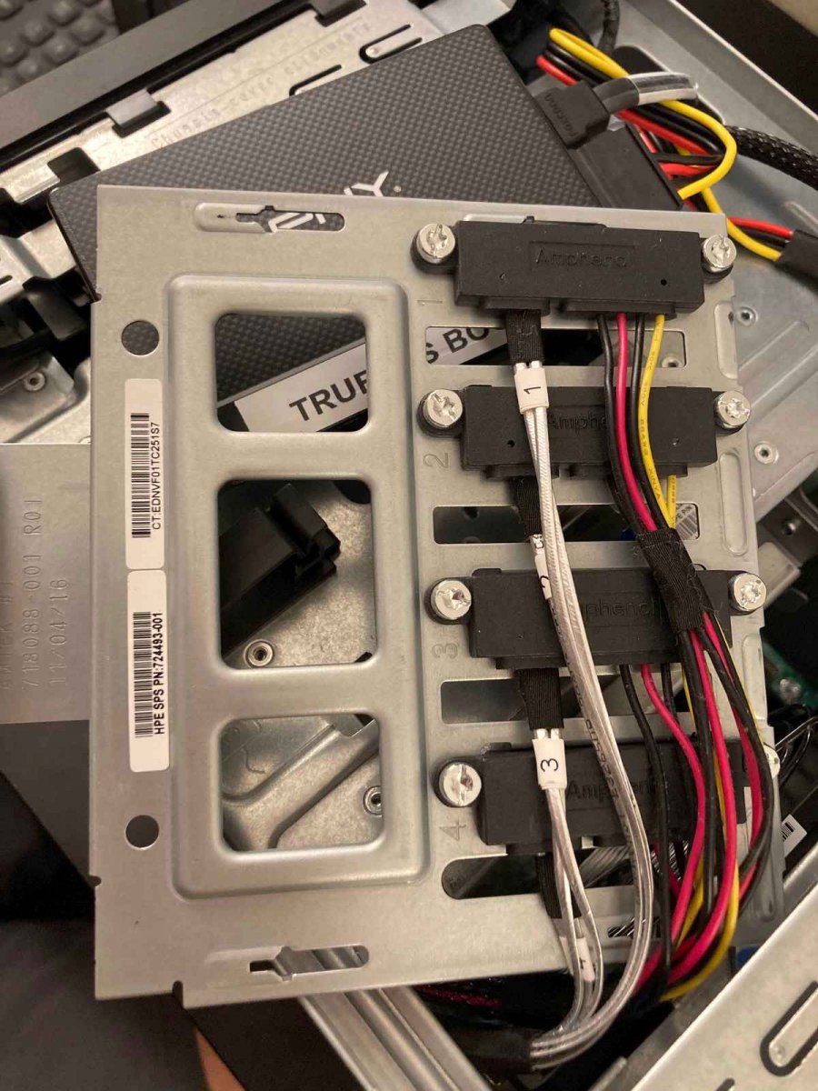

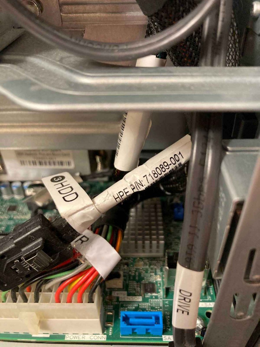

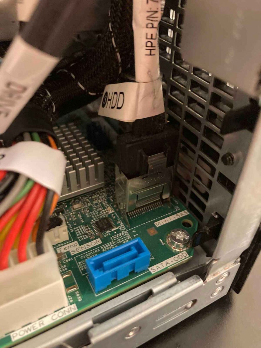

Ok, catching up: I re-read the "What's all the noise about HBAs, and why can't I use a RAID controller?" post.
So, I'm using the "HPE Dynamic Smart Array B120i", which is not an LSI HBA controller flashed to IT/IR. I was surprised that this is problematic, as I've seen many people online using the Gen8 Microserver for TrueNAS. Maybe we are all ignorant of the nuances here. I actually don't know what IT/IR means yet, but I did verify in the BIOS that this controller has write caching disabled.
I'm still not sure how to weigh the specific risk of continuing to use this controller. The most concrete thing I've understood from the post is that there is that it is less reliable than LSI controllers, and there is some long-tail risk that it stops working. I don't really understand the precise failure mode, and so I don't know how to weigh the risk against a bunch of other risks like the motherboard dying, or two disks failing in a RAIDz1, or even my server getting stolen.
It sounds like I could buy a more reliable controller for pretty cheap, but there is only 1 PCI expansion slot, and I would rather use for the upgraded NIC.
This leaves me wondering: where is the existing controller and can I upgrade the controller without using the PCI slot? I don't see any discrete controller card. The drives connect to the motherboard via a mini SAS connector that fans out to four SATA connectors, each connected to a drive. So is the controller this cable rig? Or is the controller integrated into the motherboard? I've attached some photos for reference. If the controller is not integrated, maybe there's a better controller that connects to this mini SAS slot?

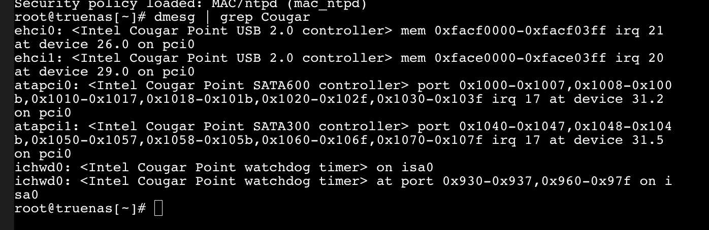

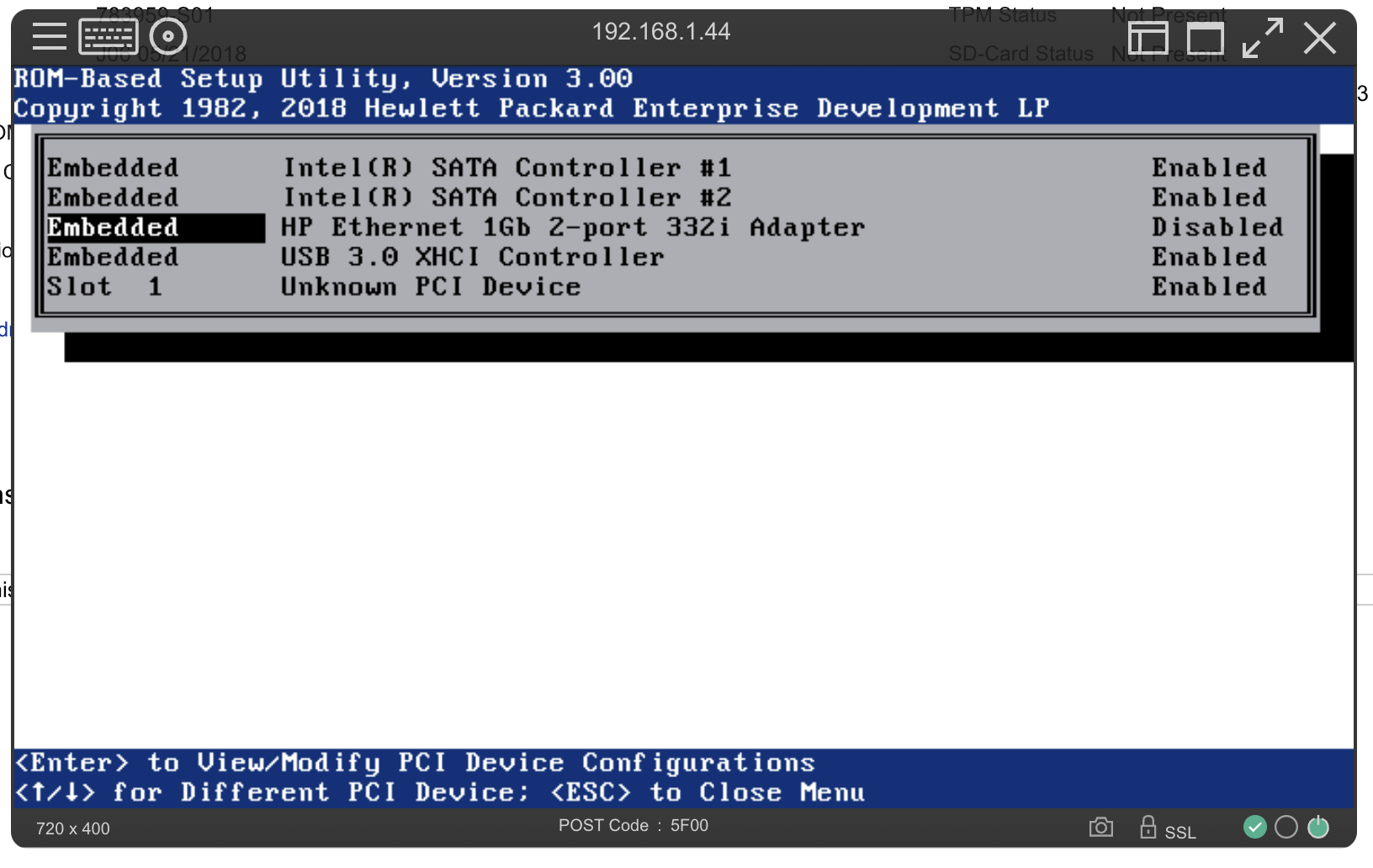

aklibisz
Aug 23, 2023
13
It looks like it's an Intel controller. I attached screenshots of the bios and dmesg output and a text file of the full dmesg.
