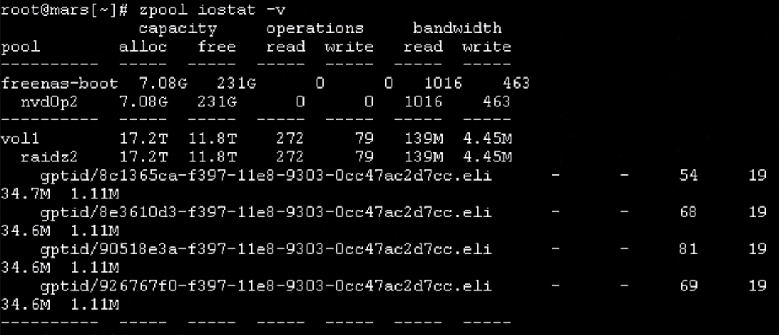

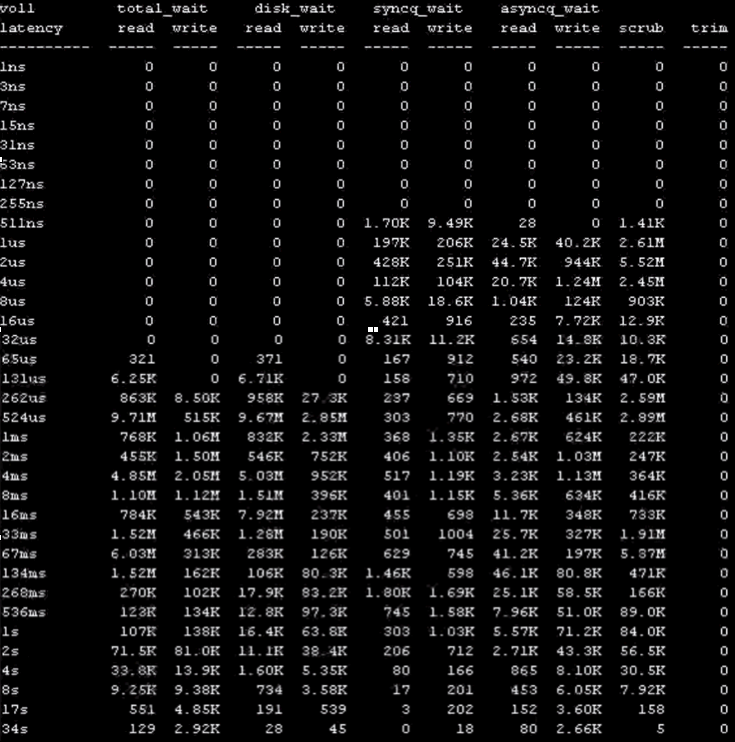

Interesting, would this SMR behavior also explain why pool performance in dd & SMB has tanked as well? One other question I have is this detectable in iostat? I've screen shot (sorry remote limitations on copy paste right now) my results below:
Yes. The nature of how SMR disks work makes them a very poor match for RAID in general and especially bad for copy-on-write filesystems like ZFS.
Regarding your iostat pastes yes, the disk_wait column is where you'll want to look and you're seeing operations in the multiple seconds of delay there.
