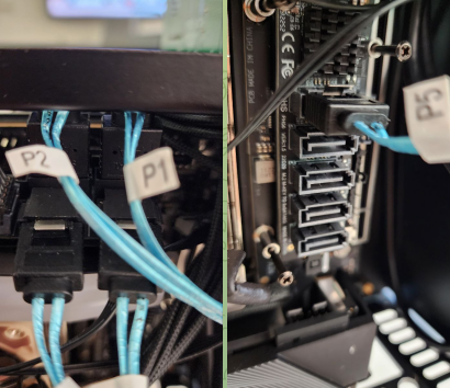

You should either use the ports on your motherboard or an HBA, but you could try using a SATA controller (not a port multiplier).
Good news is your drives are healthy.
I believe it would solve the issue as long as you use only a single port on that port multiplier.
Do the port switching, then zpool clear, replace the external USB drive with the old (internal) drive and run a scrub. You should be fine.

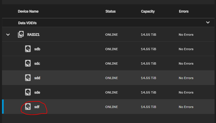

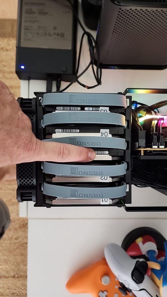

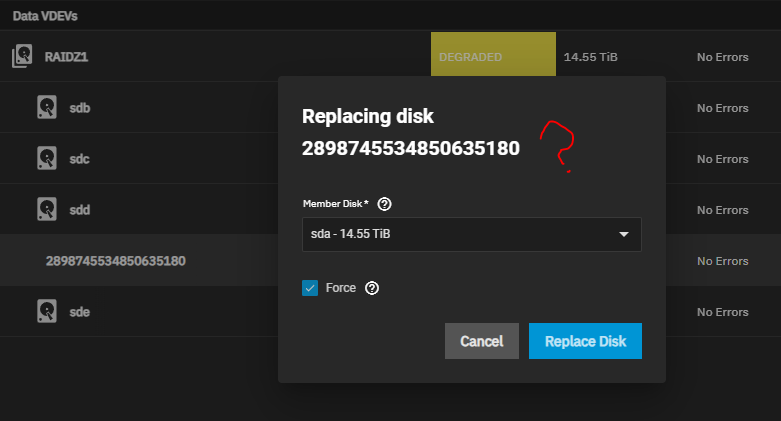

1) physically moved all the devices to the mobo as instructed :

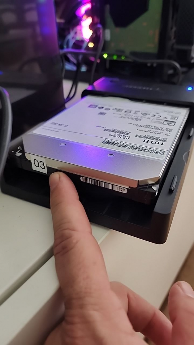

2) moved the former external enclosure drive that I mistakenly used to replace a degraded drive marked #03 HDD in pictures before
and placed the degraded #03 drive into the enclosure

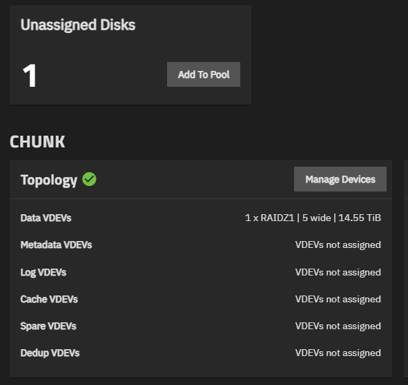

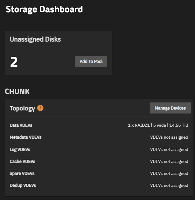

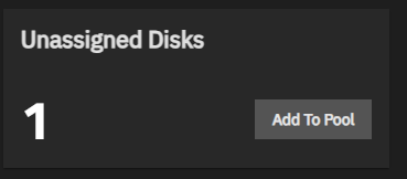

3) booted up to 2 "Unassigned disks" in the dashboard and (check update below there is only one now)
4) ran
sudo zpool clear CHUNK

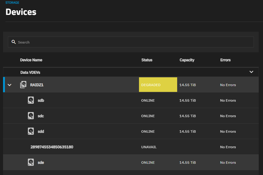

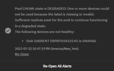

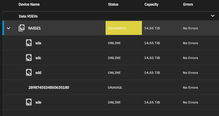

As you can see it does not appear to like it when you use a usb external enclosure to run a
zpool replace a HDD as it marks it
UNAVAIL

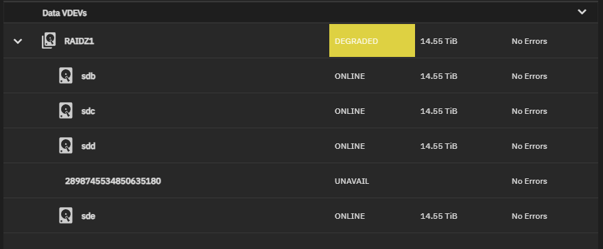

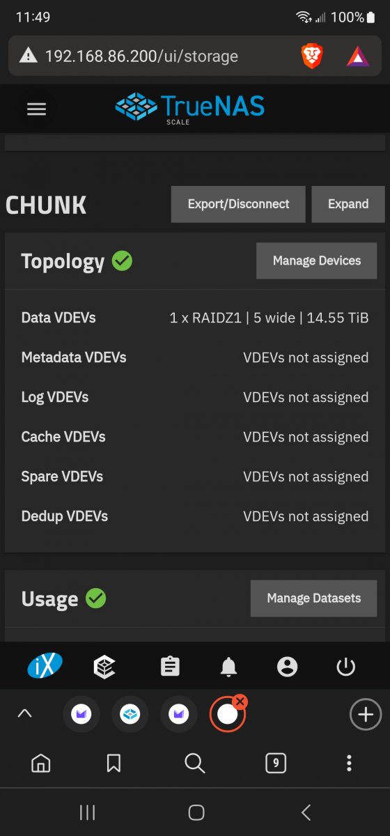

having said this - 4 drives are online and CHUNK is accessible, shouldnt I be able get rid of this UNAVAIL, add a disk to the pool and call it a day?
UPDATE* this UNAVAIL is the external (former replaced drive
Ive since turned the external off and its still showing up

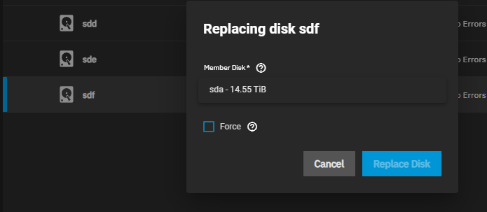

can i just replace it with the 1 unassigned disk i have?
(no, i have not hit replace disk, just showing for clarity , wont do anything without advice)
