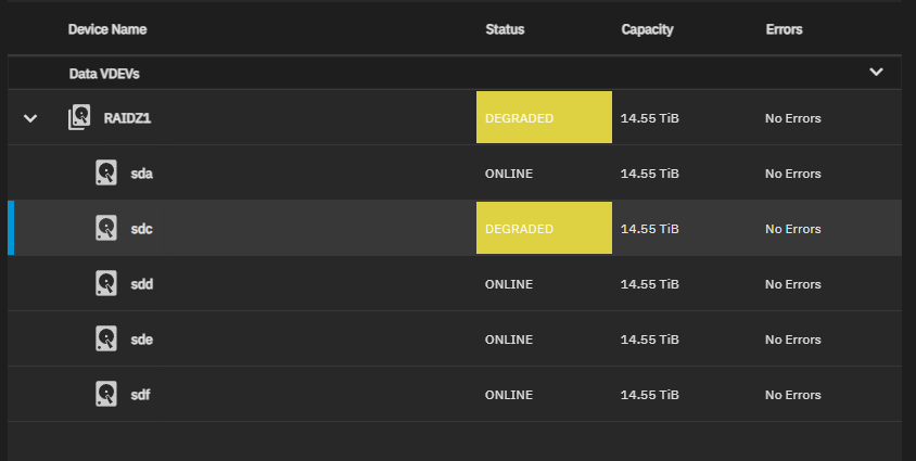

Am I screwed? I have only one spare disk .
How can I reduce the size of the pool without compromising the data?

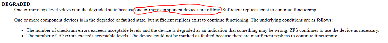

When it says "DEGRADED" does it really mean its "offline"? Am I just operating off of sda /sdc and sdd or are they all still working ?
Can I just put out the disks that are degraded?
I can put the one spare in a USB enclosure and rebuild the array with 4 disks without data loss?
Please help

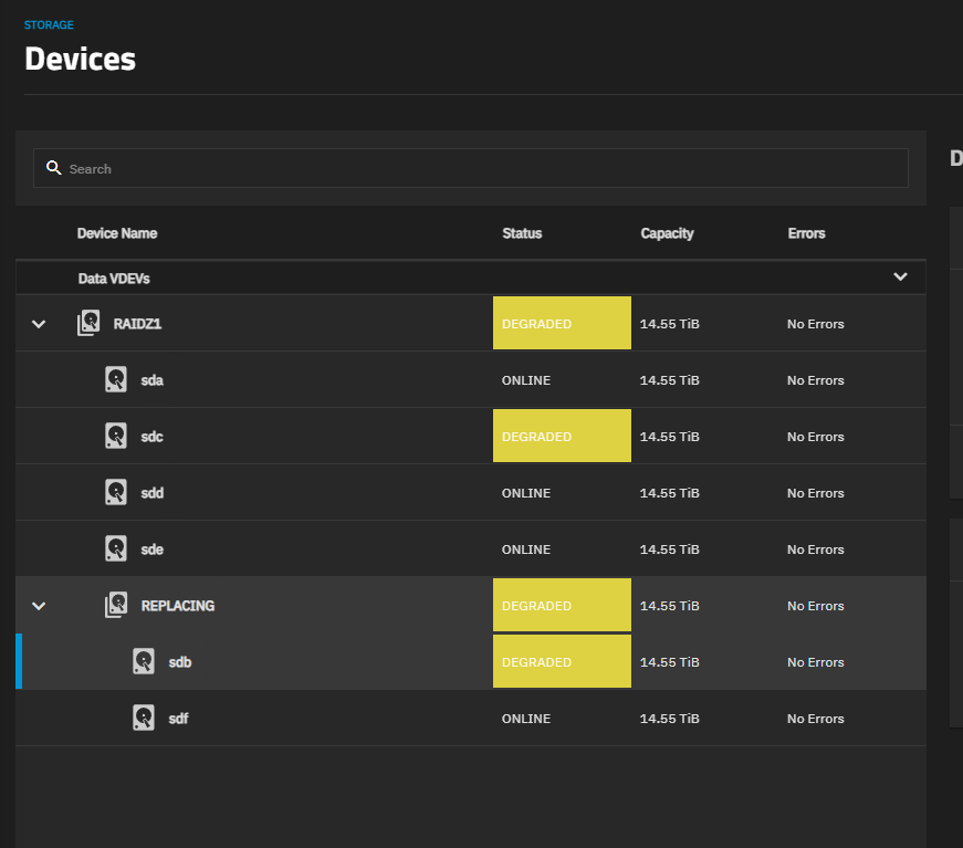

as you can see above im using the GUI for the first replacement, so I didnt use the command line.
i have no idea how to troubleshoot it :(
So after this replace op finishes - i will have only one degraded drive left.
I HAD to use an external as i only have 5 bays - and they were all taken by a drive... when i tried to physically remove one of the degraded drives the pool would disappear - so i left all the original drives in and added the external for replacement - as soon as it finishes - i was going to swap it with the one it replaced
did I do it wrong?

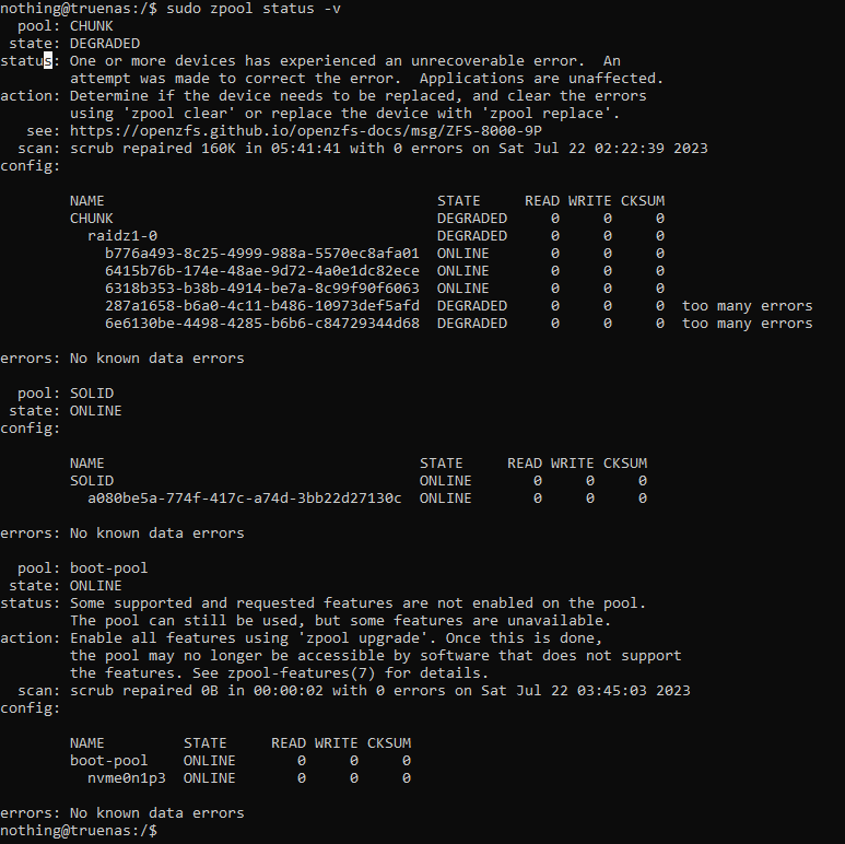

Can you put the output of zpool status -v CHUNK in code tags?

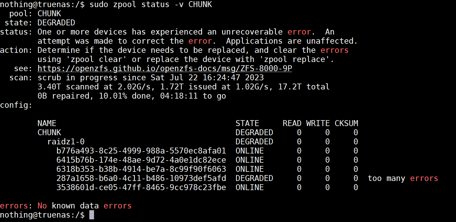

nothing@truenas:/$ sudo zpool status -v CHUNK
  pool: CHUNK
 state: DEGRADED
status: One or more devices has experienced an unrecoverable error.  An
        attempt was made to correct the error.  Applications are unaffected.
   see: https://openzfs.github.io/openzfs-docs/msg/ZFS-8000-9P
  scan: resilvered 3.45T in 08:02:07 with 0 errors on Sat Jul 22 14:50:45 2023
config:
        NAME                                      STATE     READ WRITE CKSUM
        CHUNK                                     DEGRADED     0     0     0
          raidz1-0                                DEGRADED     0     0     0
            b776a493-8c25-4999-988a-5570ec8afa01  ONLINE       0     0     0
            6415b76b-174e-48ae-9d72-4a0e1dc82ece  ONLINE       0     0     0
            6318b353-b38b-4914-be7a-8c99f90f6063  ONLINE       0     0     0
            287a1658-b6a0-4c11-b486-10973def5afd  DEGRADED     0     0     0  too many errors
            3538601d-ce05-47ff-8465-9cc978c23fbe  ONLINE       0     0     0
errors: No known data errors

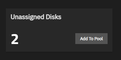

sorry it didnt disappear but all the disks went into the Add to pool count after i removed the degraded disk (pre replace operation).. but maybe i got that wrong. Sorry im a newbie with truenas and zfs

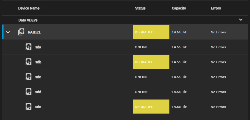

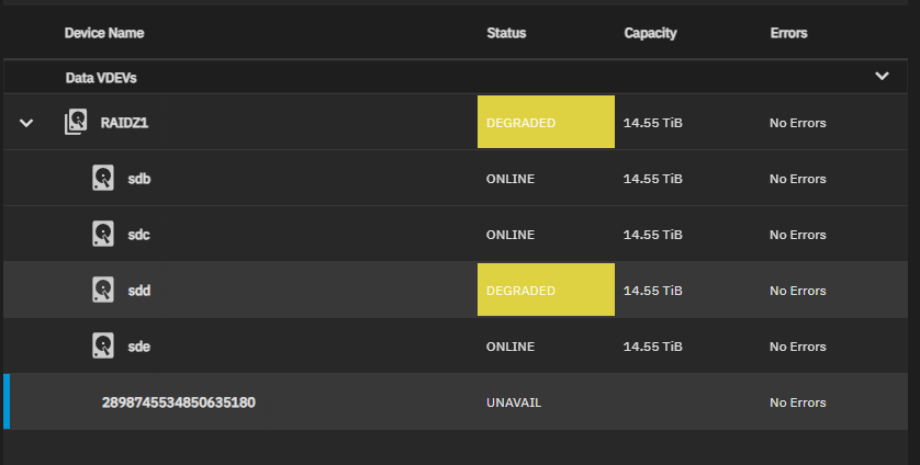

If I put the replaced drive (former sdb) into the enclosure and the new drive (former sdf) in the former sdb's slot.. it becames UNAVAIL somehow. :(
I've put everything back to the way it was new drive back in enclosure and degraded replaced drive sdb back into it's slot and now everything is there again. So odd

Looks like just putting the newly replacer drive into the replaced drives "bay" might not always work
I guess this is why it was marked "UNAVAIL" when i swapped them after replace/re-silver op

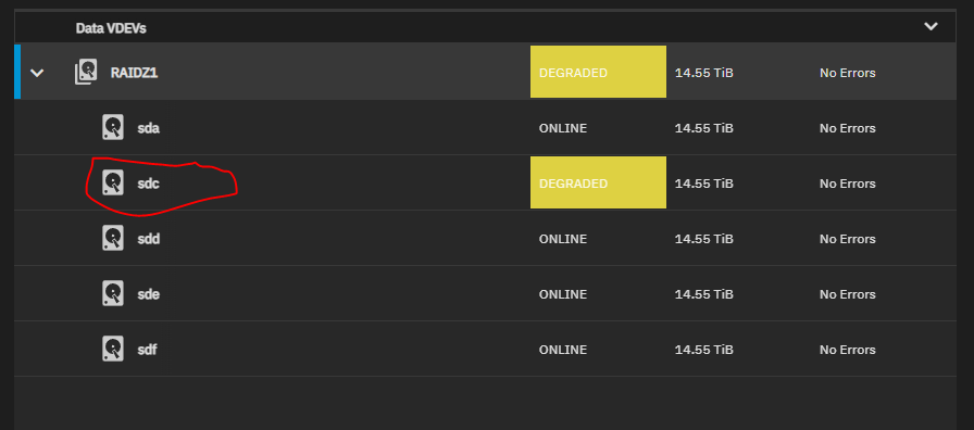

Running a scrub now to clean up the status of the ZFS as its red. However I still have one degraded disk and one replaced disk i need to sort out..
1) how can I get sdf (usb enclosure) into sdb's bay (already replaced and shows up in ADD TO POOL section) without breaking the CHUNK pool?
2) How can I troubleshoot the degraded disk sdc
