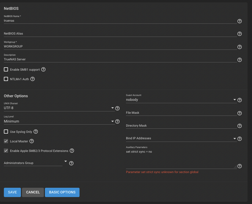

Try going into the SMB Advanced Settings (Services -> SMB -> Little Wrench Icon) and enter set strict sync = no into the advanced parameters. Restart the SMB service and see if that improves the write side of things.
Is that for Scale? I'm using core, and I have a "pen" icon instead of a wrench in the Services panel next to the services name. And typing set strict sync = no into the auxility parameters gives and error.
Sorry, leave out the "set" part, so just strict sync = no
