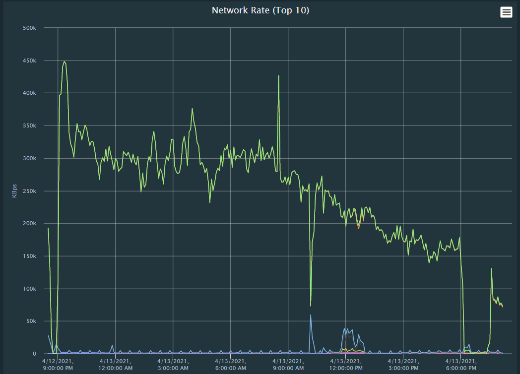

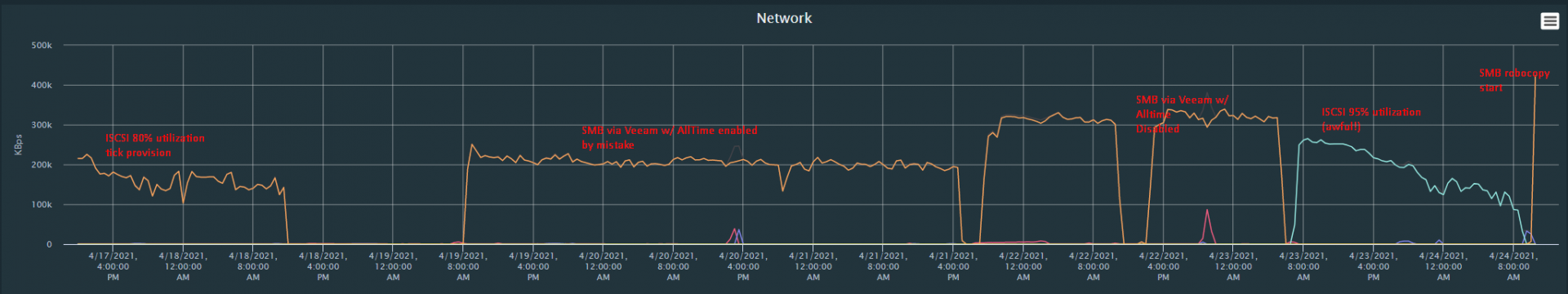

The benchmark I'm comparing this against is having this same 11x 8TB SATA array as a DAS vs. TrueNAS, both as VMware datastores. As a DAS, I could reliably get almost 300MB/s for large sequential writes and it maintained that performance throughout 50+TB of writes. TrueNAS in iSCSI config gives me almost 600MB/s initially but degrades to under 150MB/s after only 20+TB of writes (I didn't want to see just how awful it got after that).
TrueNAS as SMB gives me at least 600MB/s to start with (likely limited by my source 12x 6TB SAS DAS array) which degrades to around 450MB/s towards the end of 50+TB of writes. It's an improvement over the DAS but one of the main goals was to get shared storage working and SMB doesn't give me that. I guess I can live without it but I'm questioning whether the increased performance of TrueNAS is worth the extra power consumption of an entire R710 for nothing more than non-shared storage
