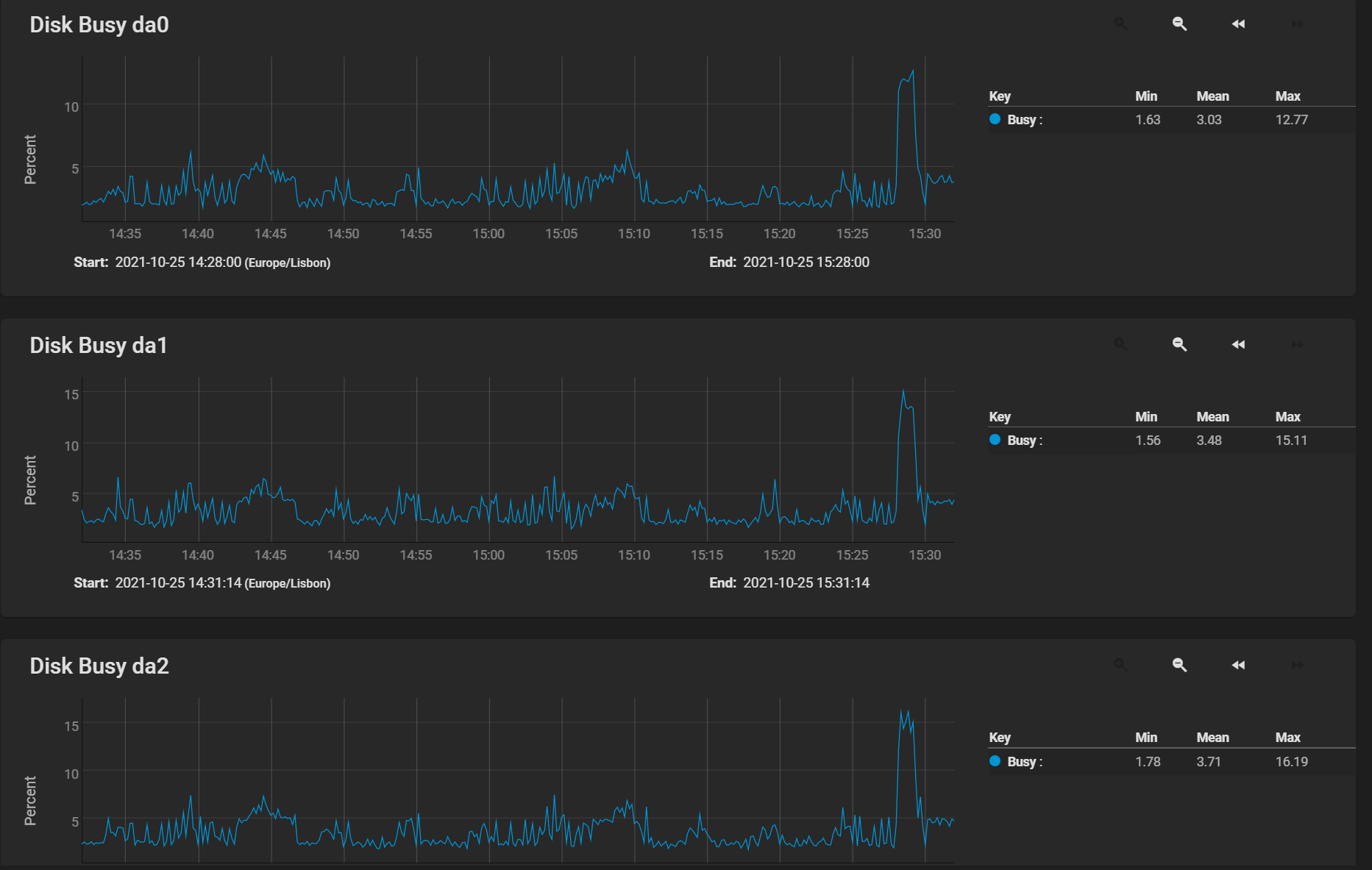

@c77dk @Samuel Tai I have a hard time accepting that the fact that a pool is with 1.4TiB free is now horrible in performance.
Specially considering the disks are sleeping almost, the average busy time per disk is 12%, very very low.
CPU usage is very low, memory is plenty for this volume size, disks are not maxed out, not even close.
@jgreco Thank you for the insights.

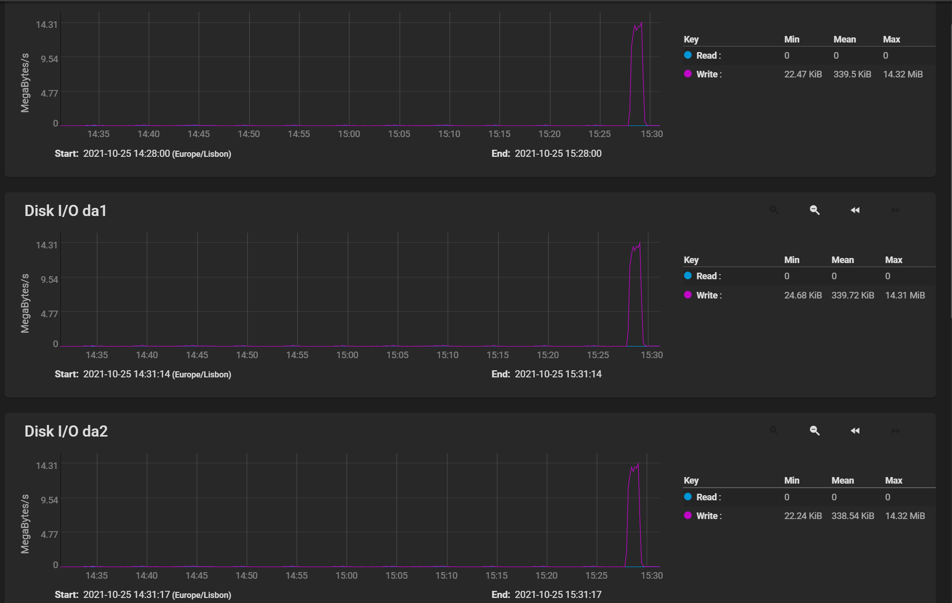

Yeah that would be my expectation also, but when I look at Disk I/O, the disks are not reading at all, leading me to believe its fine for the file size I'm transferring.
The screenshot bellow is while copying a 15GB File, it transferred 8GB and I canceled, but you can see 0 Read during this Write process.
Disk Busy:
I'm just showing 3 of the 5 drives due to the screenshots size, but the other 2 are doing the same.
Because of this I don't think its due to being at 86% filled, its still has 1.39TiB free and I'm copying like 50 to 100GB of files.
If the available space was the problem in this case, it would be a massive optimization issue on ZFS.
Any other idea?
Thank you.

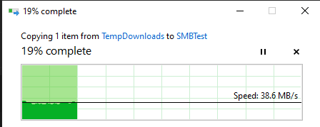

To add an update regarding my write issue and to counter argument everyone leaning on the storage used on my main pool being high, even though there is no indication of that being the issue.
I just created a SMB share on a Pool that is 7% Used (207GiB Free), running on a single Samsung SSD.
And even against an pretty much empty SSD, writes don't go over 40MB/s anyway.
This is a 50GB file transfer:
So this leaves me to 2 possible issues:
- Networking - This is unlikely, its a Intel Nic on client desktop machine running at 1Gbits and the NAS is also using Intel Nic, with 2 ports on a LAGG. I've had this setup like this for a very long time, however I'm only using 2 of the 4 LAGG ports I have configured.
- Issue with FreeNAS
- Issue with the Client.
Any ideas or suggestions would be appreciated.
Thanks.
