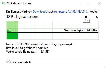

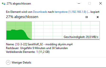

If I copy a large file the speed plummets after a few seconds:
from:
to:
What can I do to maintain the speed the whole time?

The data has something like 5 seconds to sit in memory and then starts to ferment, so if the drive array cannot keep up the server will stop accepting new data until the current data is written. Tweaking the settings manually is dangerous.
You can, in my limited experience, set the array up so it's faster, add an NVME cache, or use Ubuntu and software RAID with ext4.

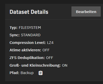

Can we see a screenshot of your dataset settings just to sanity check them?

So your RAID-Z1 of 3 drives will have a streaming write speed of 2 of your 3 drives. So let’s say the drives can do approx 185MB/s you would get two times that so 370MB/s or 2.96Gb/s. This is the absolute theoretical best you can expect from your current setup when hitting your data pool just to put things into perspective.
this details?

Yep. That all looks fine.
