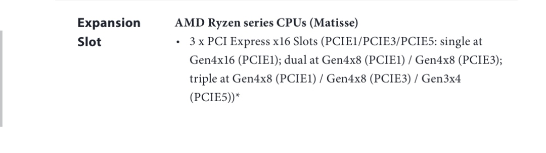

Bifurcation is the setting that changes the PCIe allocation of the slots.
While every slot is electrically wired as you listed above that does not mean that you can use all those electrical connections at the same time.
They are usually oversubscribed because users nearly never populate all the slots.
Usually if you populate the first and second x16 slots they both become x8.
But that might be different for your motherboard.

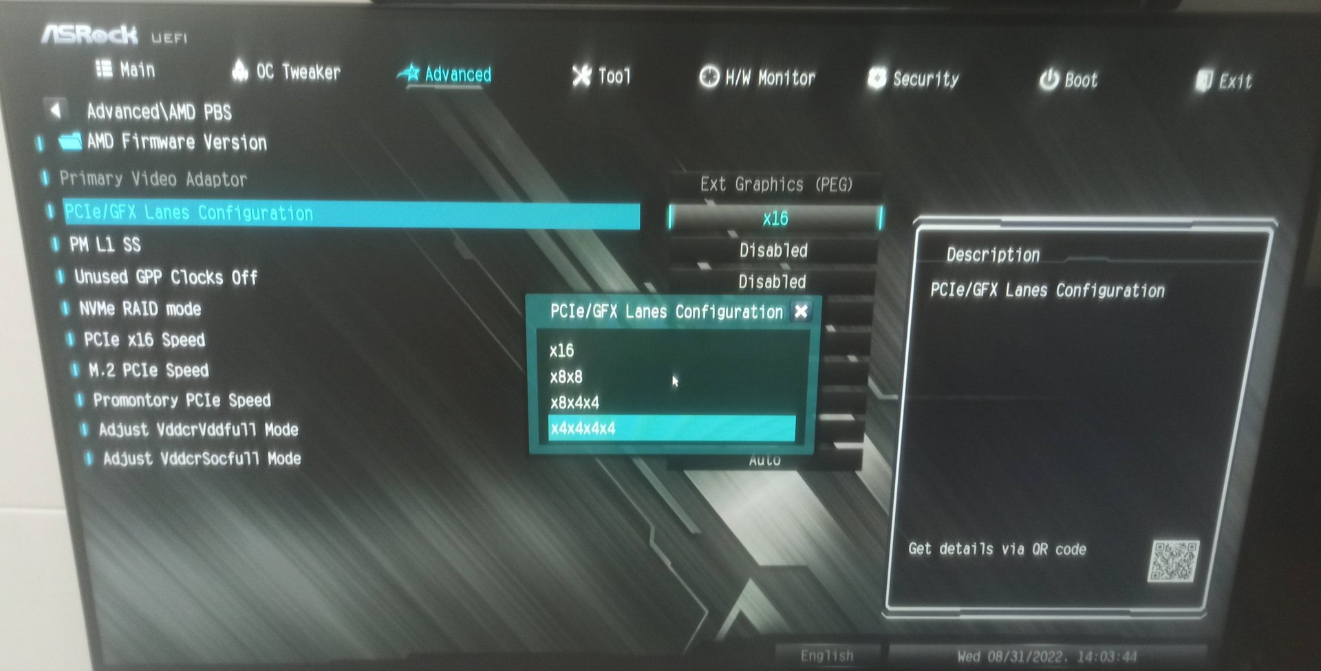

The setting to adjust the lane allocation on an AsRock Board is in the attachements.

"PCH" (Platform Controller Hub) is the chipset. Sorry for the unnecessary spilling of technical jargon.
If there's a GPU in the other x16 slot, the symptoms look like the GPU retains all 16 lanes for itself. Look for bifurcation settings (as exemplified by @asap2go ) and set it to x8x8.

Yeah, I tried setting the PCI allocation to 8x8, but that didn't help. The only thing so far that made a difference was disabling the onboard ethernet.
