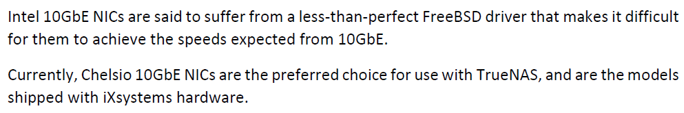

From the hardware guide :
So I would say no for the 2nd card you mentioned.
All I can recommend is to go through the thread dedicated to 10Gb networking card : https://www.truenas.com/community/threads/10-gig-networking-primer.25749/
