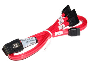

A multilane connector may be broken into its four individual lanes using a breakout cable. For example, if you get an SAS HBA, it probably comes with one or two SFF8087's on it, but you may want to directly attach hard drives. A breakout cable allows this. This is a SFF8087-to-single-SAS breakout cable; this is a SFF8643-to-single-SAS breakout cable.

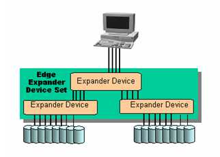

SAS Expanders
A SAS expander essentially takes a SAS multilane connection and allows the attachment of additional SAS devices. These devices all share in the available bandwidth of the SAS multilane connection. SAS expanders can be cascaded as well. In the following picture:
we see three SAS expanders. The first one only distributes to the second and third. The second and third each attach to hard disks. Modern expanders typically have enough channels that you wouldn't need to cascade them for just this small number of disks. A typical modern expander might have 36 lanes, allowing 24 disks, two upstream four lane host connections, and a downstream four lane connection to another expander.
There are advantages and disadvantages to expanders. A primary advantage is cabling simplicity: if you have a 24 drive chassis with a backplane that uses an expander, you need only a single SFF8087 to attach from the backplane to the HBA. The two main downsides are that those 24 drives then share the 24Gbps that's available on a SFF8087, and that in some cases some specific SATA disks have been known to not play nicely and have caused problems for other attached devices on a SAS expander.
