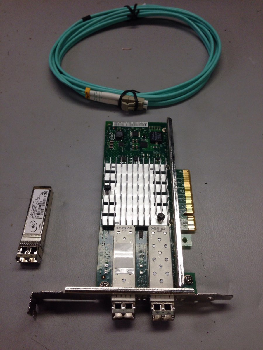

Here's some of the parts you might be using with a fiber deployment.
On the top, a nicely built OM3 aqua fiber patch. This is a nice quality cable we sourced from "cablesandkits.com", which has several little awesome touches. First, look at how neatly they assemble it for shipping, with the fancy cross-laced twist-ties on both connectors. You can see at a glance that there's some TLC that goes into it. There's a section of heat shrink tubing that prevents further splitting of the fiber a few inches from the connector, and that the connectors are neatly spaced from the end of the fiber. This is something I've found to be often off on cheap fiber - one connector being off by a centimeter or more. And polarity markings, so that you can identify which strand is which at each end.
Grades of fiber below OM3 exist. Most 62.5/125 fiber (OM1) is capable of running 10G for at least two dozen meters, and basic 50/125 fiber (OM2) is sufficient for most SOHO purposes (several dozen meters). OM3 will get you 300 meters. But just like HDMI, it is a digital signal - there's no value to be had in buying a $1000 cable if a $10 cable works without error.
Click to enlarge.
On the bottom, an Intel X520-SR2. This card includes SR optics, which are removable from the SFP+ cages. If using optics, Intel does require the use of their optics, and the cards usually come with the Intel variant of the Finisar FTLX8571D3BCV-IT. Do note that other non-Intel optics are not likely to work in the card!
The other end would be an optic plugged into the switch of your choice. Again, these may be vendor-locked. We have the occasional argument about this over on NANOG, but basically most people understand that vendor locking is a transparent ploy to make you buy marked-up optics. So do yourself a favor and buy them on eBay, used, from a reputable reseller, probably for about what a generic optic would be new.
