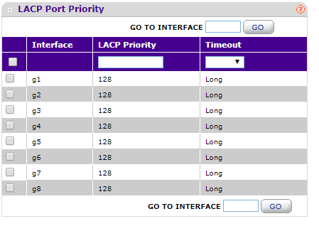

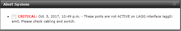

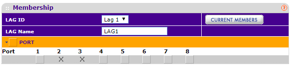

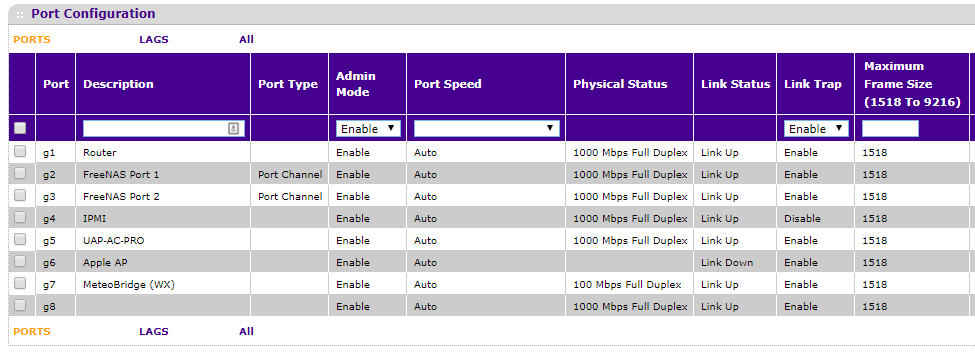

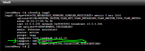

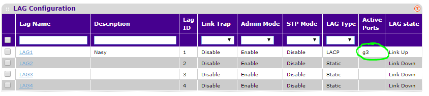

UPDATE: I'm one of these REAL special kind of people.
I told the Netgear the WRONG ports to LAGG. I have (1) out of the (2) correct..
Thanks for the sounding board!! LOL
So i'm finally messing around with LAGG on my old server with the latest stable Freenas installed (U4).
I have a Netgear GS108T switch that supports LACP.
I was able to set up my LAGG in FN and turn everything on in my Netgear to get LAGG running.
Now, i KNOW.. my crappy Freenas system is NOT to code, I don't use it other then to test things out so don't freak out on me!
I have looked everything over and played with setting but I keep getting this message.
So, I did "ifconfig" and found this..
I see that for whatever reason, only (1) of my ports are working. So I went and did more digging on my Netgear but couldn't find any more "things" to mess with.
I have the following info from my Netgear. You'll notice that it too only shows (1) port active. But if I change the LAG type to "Static" I loose connection to my Freenas but it shows activity on BOTH ports...
Only thing I can think of is do I need to type "up" in the options in the Freenas LAGG section?
Ok, sorry for all the pictures, I just want to make sure I gave any info that I have in front of me.
Thanks for all the help guys!
