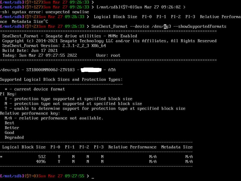

The drives I am testing are the Seagate EXOS 18TB and while trying to understand the migration setting to switch from 512e to 4Kn (I have contacted Seagate support in the matter), I went to read through the SeaChest series of utilities documents, and it would appear there may be a specific series of test SeaChest could perform to write patterns to disk.

On a second note, if I am able to perform transition from 512e to 4Kn, then theoritically, I would have to undergo the same stress test as I believe the physical location of the block  maybe slightly offset from where the 512e block resided.
