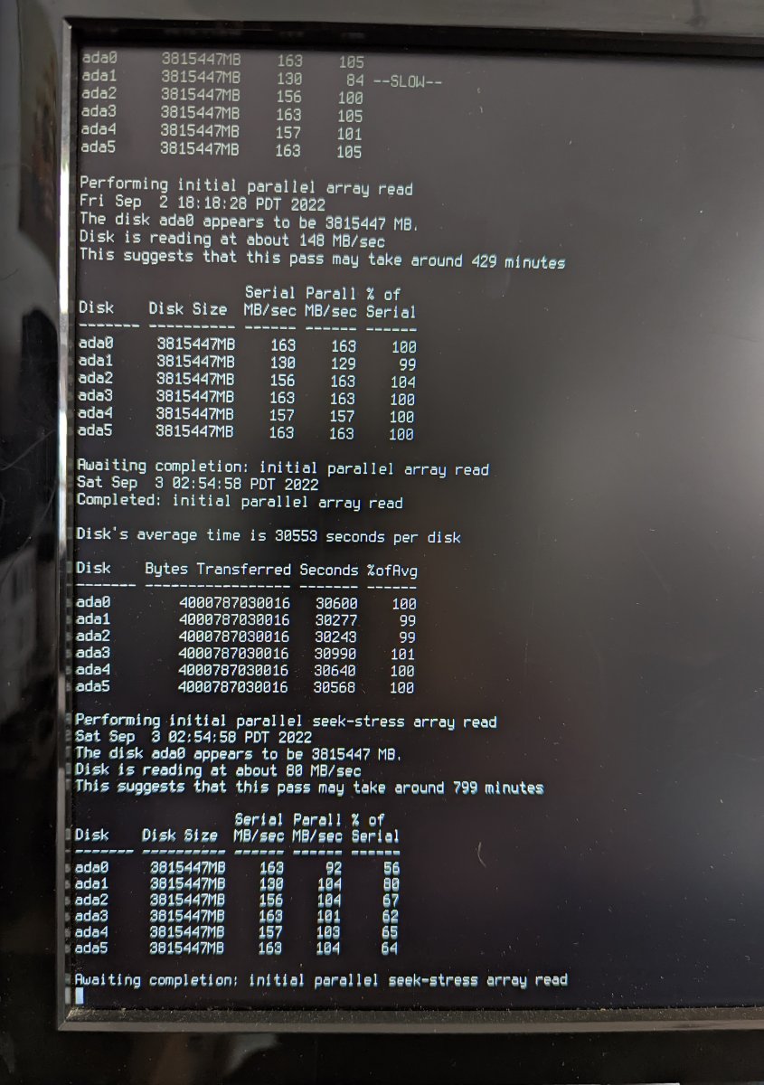

Does this script run the tests in parallel? How do I know how far along it is?
I have it running about 12hrs now, on 6 HDDs.
