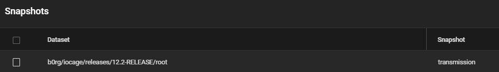

Can anyone tell me why/how a snapshot was taken when I followed this resource? This is what my current snapshots are showing:
What step created this in the process? Where is this snapshot stored? How can I have consistent snapshots taken in case I need to start over?
