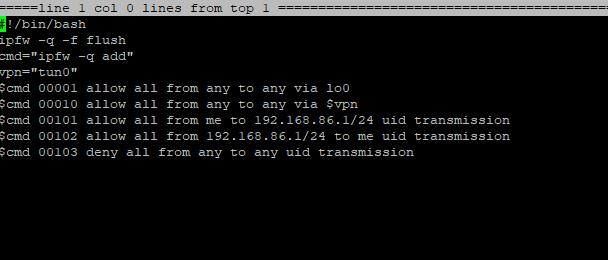

vi /etc/ipfw.rules
Type the below into the file and save it, change the 192.168.1.0/24 to whatever your personal network is setup as:
#!/bin/bash ipfw -q -f flush cmd="ipfw -q add" vpn="tun0" $cmd 00001 allow all from any to any via lo0 $cmd 00010 allow all from any to any via $vpn $cmd 00101 allow all from me to 192.168.1.0/24 uid transmission $cmd 00102 allow all from 192.168.1.0/24 to me uid transmission $cmd 00103 deny all from any to any uid transmission

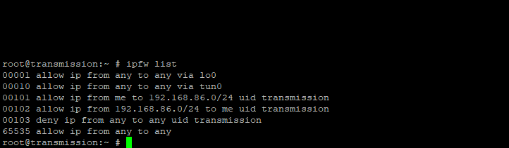

service ipfw start
ipfw list (make sure its listing the rules typed above)
test the firewall by running a large torrent file (I used ubuntu torrent), and stopping the openvpn service mid download.
If the firewall is working, the download should stop downloading. Once it does, start openvpn again and it should resume download.

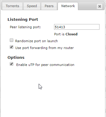

Few problems after setting it up:
downloads are REALLY slow. Is it because the TCP port is closed? Torrent is downloading at less than 30kb/sec. I've forwarded 51413 with the transmission IP but it still just shows closed.

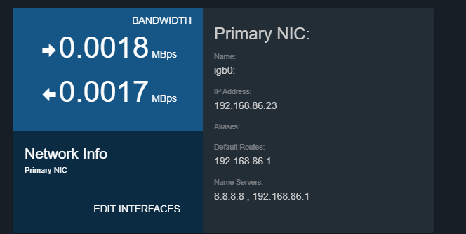

  • edit /etc/ipfw.rules (change to Default Routes IP which shows up on Dashboard of Freenas)
