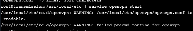

Following these guides:
- https://www.ixsystems.com/community...-transmission-openvpn-pia-ipfw-tvnamer.72523/
- https://github.com/danjacques/freenasdocs/blob/master/guides/vpn-client-jail.md
Pretty much got all the way through with the first one but openvpn won't start. (says .conf file is not readable)
RC.conf file:
openvpn.conf file
https://i.imgur.com/hyP46un.png (I put my username/pass in pass.txt)
/usr/local/etc --> https://i.imgur.com/nT9SvOG.png
Looks like openvpn.conf is in the wrong directory. Create openvpn in etc and move the conf to there.
Supa
Jan 10, 2014
204
yeah sorry i fixed it.
