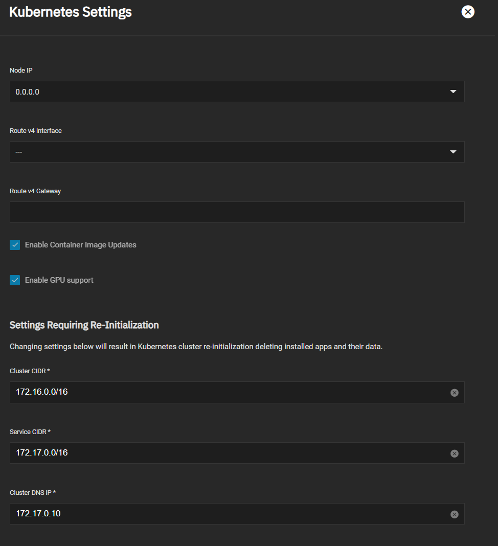

Hi, after upgrading from SCALE-22.02-RC.1-1 to SCALE 22.02-RC.2, the apps installed via Truecharts cannot resolve hostnames anymore. I use docker exec and try nslookup and it fails. The DNS IP is 172.16.0.10 as default. In Network->Global Configuration->DNS I use cloudflare DNS (1.1.1.1), if this matters. By the way, apps that installed manually (not via Truecharts) work as expected (their DNS is same as global configuration mentioned above). Has anyone faced this issue as well? Thanks.

@li_chang can you shows us an example of what you're trying to resolve?
If it's a Docker container name it won't work since Kubernetes uses a different DNS convention and 172.16.0.10 is the CoreDNS resolver IP address. It will work just fine with stuff like <service-name>.<namespace>.svc[.cluster.local] but not with Docker container names.

I too am also having issues with DNS from containers. However, i did find a workaround, but it takes a moment for it to be utilized so it doesnt always work when first deploying the container.
I have networking set to simple and it seems that from withen a container I cannot not resolve any DNS, at all. I tested this via a curl command to google.com and was met with a "Could not resolve host" error.
If i modify the settings for the said application, and set the networking to Expert and leave host network off (didn't try it on) I can then assign my application a network IP, gateway, route and dns servers. I modify the DNSPOLICY to none and put in my main DNS server on my network and it works.
So the issue seems to lay somewhere in the kubernetes layer. For whatever reason the default assigned DNS servers from kubernetes is not routing traffic upstream if its unable to resolve the host from its own DNS.
