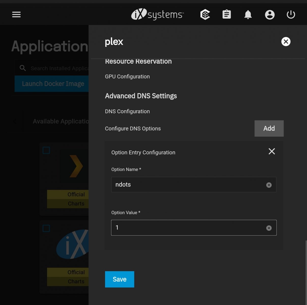

96
thanks for this I can run Plex finally. I have TrueNAS-SCALE-22.02.1, and adding ndots was the fix for Plex chart.
