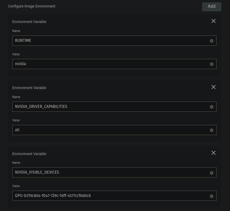

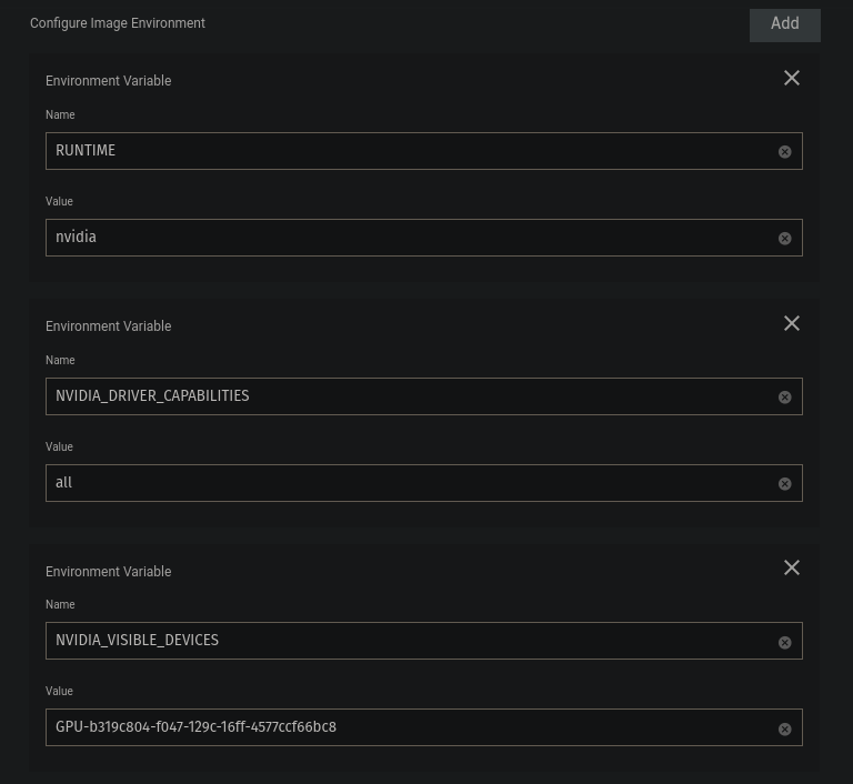

I was curious if multiple apps can utilize the same Nvidia GPU? I currently have Plex installed utilizing my Nvidia GTX 1650. I was trying to add Tdarr from truecharts so that I could transcode my entire media library. When I allocated the GPU to it as well the app would never deploy. So I changed the Tdarr app settings so it is not allocating the GPU and the app deployed instantly. I have little to no experience with k8s but from my understanding the plain nvidia-docker2 container, it is able to allocate the gpu to multiple containers. Is this not possible on TrueNAS Scale since it is using Kubernetes?
Apps can share the same GPU. I've been doing it forever. When your setting up the deployment, do not allocate GPU to it as it will not allow any other pod to use it.
Set your env variables like this on each deployment to utilize GPU:
GenericEric
Aug 28, 2022
9
For NVIDIA_VISIBLE_DEVICES value, you need to insert your own device or simply insert `all` to utilize any GPU.
This is not likely to do anything of value, as this is literally set by default on all gpu consuming containers.
It also does not give access to the GPU device on a permissions level.
While there definately are a few sneaky ways to pass through multiple containers to the same GPU, that definately requires the use of hostPath mounts and/or device plugins. With these env-vars no one is going to get GPU access.
If this would've been working/true, all our apps would get magical access to all NVIDIA gpu's even without them being selected
This actually seems to work for me, at least for a custom docker image. I have a tensorflow container that I used to have "Allocate 1 nvidia.com/gpu GPU" set for. Switched it to allocate 0, added the ENV variables, and it's definitely picking up the GPU.
It's important to note that the "Launch Docker" button, runs everything as root by default. So a lot "normal" security precautions are thrown out of the window. ;-)

I think truecharts was pointing out that
is already set in the containers that can utilize the GPU so it's unnecessary, which I confirmed. I'm not sure however if they run on Nvidia runtime by default though. They don't seem to since my deployments don't work without the variables.
There has been a lot of folks looking for this functionality, I was just adding my voice and a screen scrape showing that this is indeed real. This shared approach combined with the keylase driver patch has significantly improved the advantage gained by adding the T600 card.
It's good to hear that the NVIDIA_VISIBLE_DEVICES variable is not required, I will remove that from my config as well. ... simpler is better!
Lets make some guesses here... maybe the nvidia device plugin, reads the env-vars?
