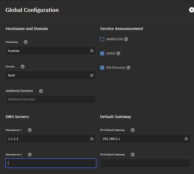

Hi, I have DNS issue in the following machine.
OS Version:TrueNAS-SCALE-22.02.2.1
Product:PowerEdge R720xd
Model:Intel(R) Xeon(R) CPU E5-2630L v2 @ 2.40GHz
Memory:31 GiB
The issue is that when I deploy any app either official or truechart (I am trying with qbittorrent), It can ping with IP's but can not resolve donaim names inside of the app.

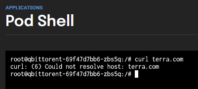

Inside of app:

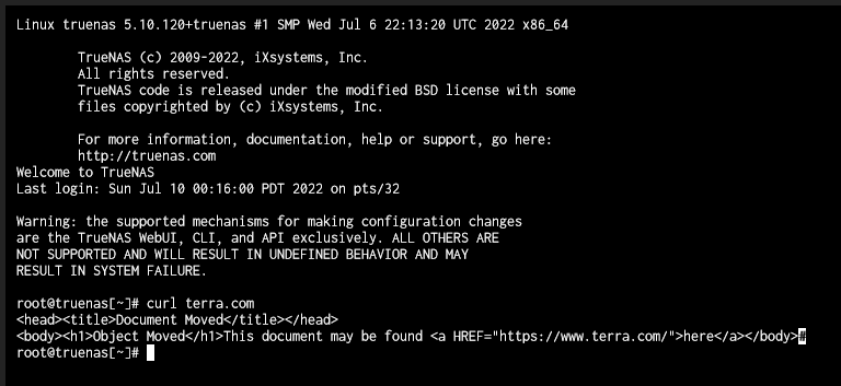

Truenas main shell:

I have tried using DHCP, also I disable my adguard docker even it is not used as DNS in truenas.
Can someone share some idea to test?
Thanks

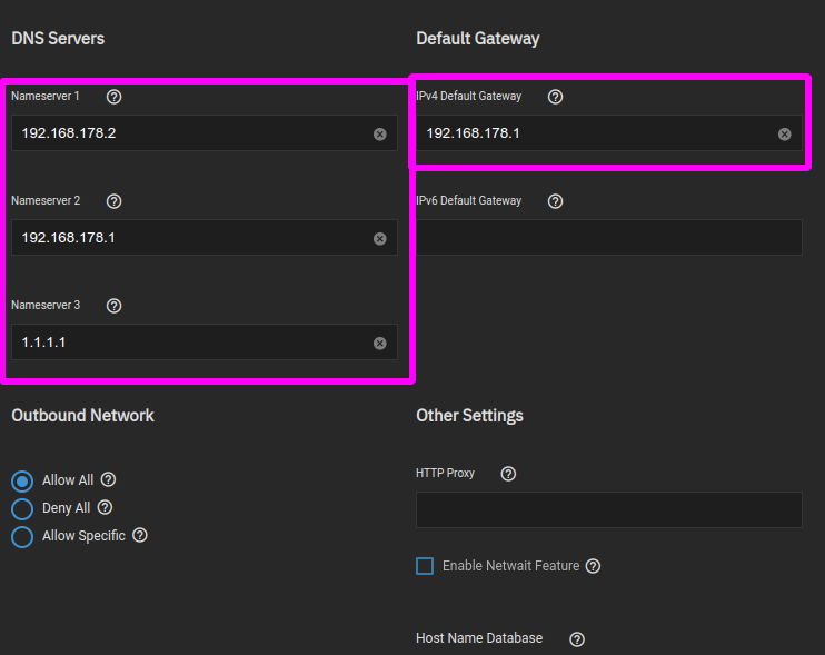

I got it running, somehow. What I did was to add, in the networking tab, multiple DNS servers and the gateway, as seen in the picture below.
After rebooting the TrueNAS Scale host, things magically started working.
@iragoiko - maybe it's worth taking a shot?
are 192.168.178.1 & 192.168.178.2 your internal dns like unbound or pihole?
tudorsmt
Jul 27, 2022
5
192.168.178.2 is my pihole, running on a separate machine in the network. 192.168.178.1 is the all-in-one router/DNS/magic from my ISP. 192.168.178.1 is also the upstream for my pihole. Could this be an issue?
