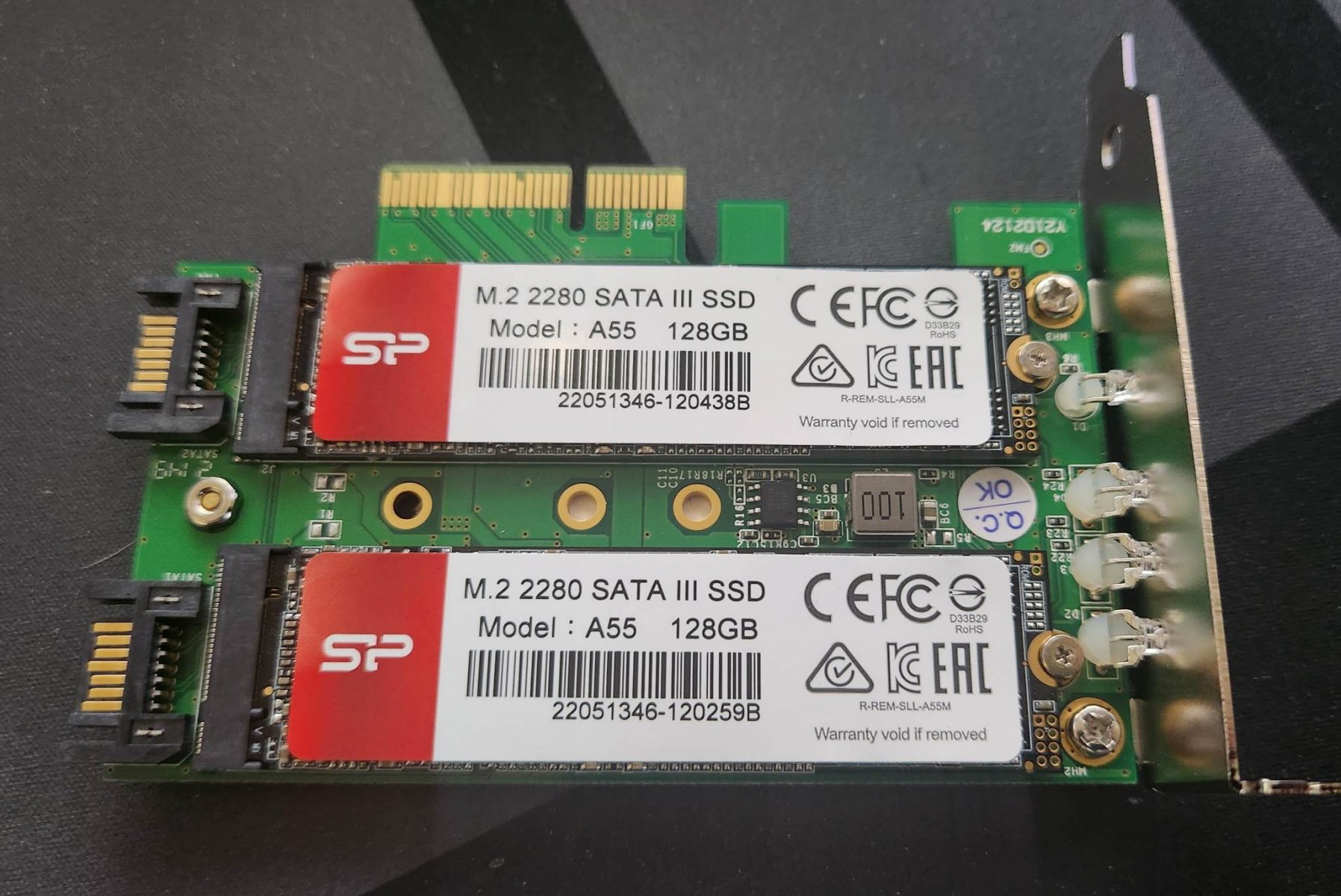

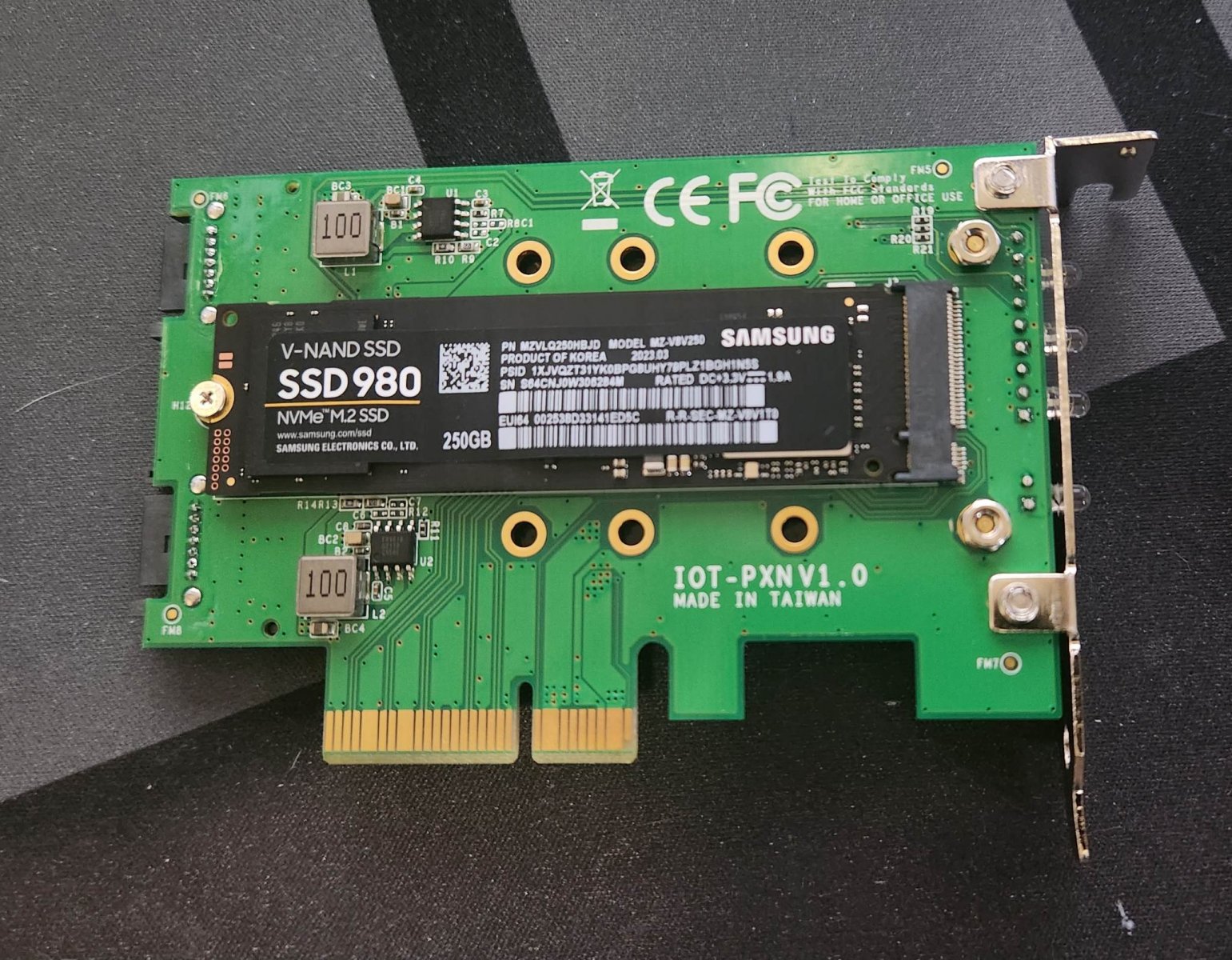

I've received the card, the M.2 and the breakout cable. I'm still waiting for the IR HBA that's taking longer since it's from China.
I'm afraid I haven't understood correctly the setup described in the resource page for this setup since there's no SATA connection as expected as you can see on the second picture. Although this makes sense since in the product description it was saying that the 3rd one is a PCIe M.2 only whereas the first 2x are SATA M.2 only.
The 980 is connected to the PCIe connector and uses NVMe. The two front cards are SATA and are merely powered by the PCIe. You will use the breakout cable to connect the two SATA connections on the card to the IR HBA. This is one of those weird freaky servery things where you are not connecting cables to the mainboard. Once you connect the IR HBA to the two SATA M.2's, you make a RAID1 out of them and that gives you a reliable boot device. The 980 is (I'm presuming you're using it for) ZFS redundancy, since ZFS cannot get a failed block on SATA#1 by asking for it from SATA#2; the IR RAID precludes that option. Instead you get it from the 980 and then just write it to the IR RAID, which writes it to both SATA#1 and SATA#2. This gives you both ZFS checksumming/redundancy and also reliable (RAID1) boot.

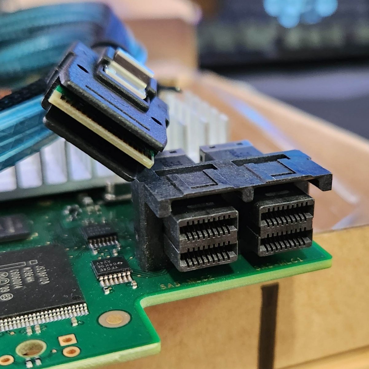

Your cable is SFF-8087, the connectors on the board are SFF-8643. Broadly equivalent, but a different form factor.
