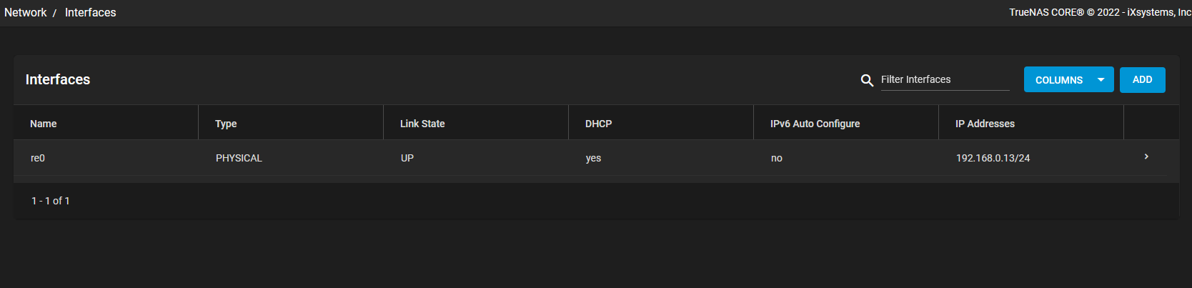

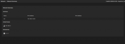

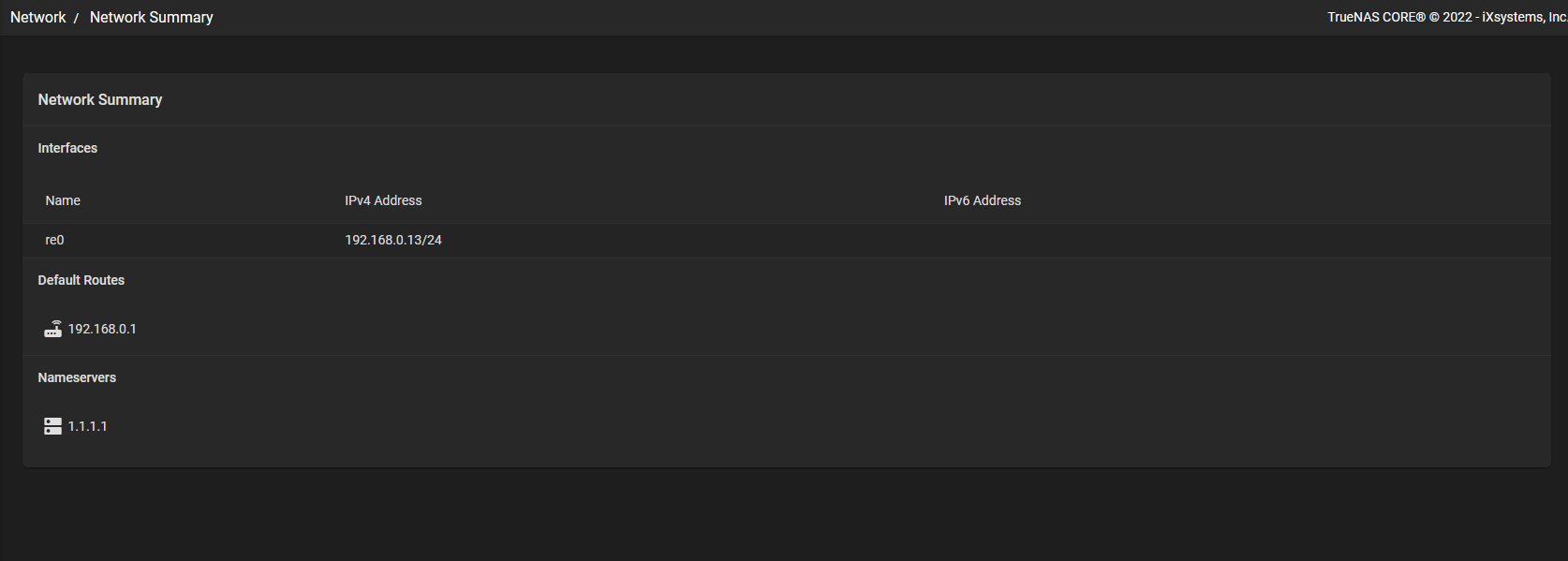

I recently upgraded to truenas 13 from 12 this is when the problems began. First I started to get DHCP errors when starting a plug, after a ton of troubleshooting I somehow fixed it by disabling hardware offloading. I'm not sure how that fixed it, anyways I recently turned my NAS off and upon turning it on again the problem has returned but much worse. At this point I cannot even download plug ins (In a troubleshooting effort I deleted and tried to reinstall adguard) and get this error- adguardhome had a failure: runtime error message:pkg error pkg-static...no address record please check your network partial plugin destroyed. I dont understand what is happening at all. I pinged the DNS server successfully in the shell, pinged my router and pinged GitHub. I tried turning off dhcp in the jail and input the static ip only to be met with a vnet error Im at a loss, I know this is very vague i just didn't know what to cover because I don't even know whats happening. This is also entirely inconsistent my plex plug in is running just fine, my homebridge plug-in has an ip is online, but isnt functioning. my next cloud plug in throws a dhcp error at me. Really just considering downgrading at this point, since it was working fine.
Plug ins im trying to run
-adguard home
-home bridge
-plex(is working fine somehow)
below is my network config please help, I will answer any additional questions, thank you.
