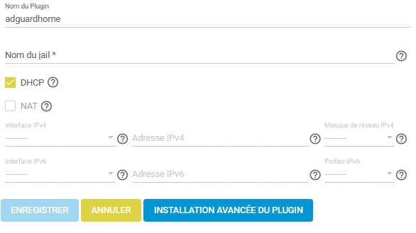

To install this plug-in, I go to : Plugins > AdGuardHome > Install
Next, I have this windows :
By default, DHCP is checked, I enter a name for the jail and I save.
