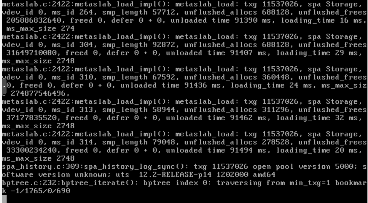

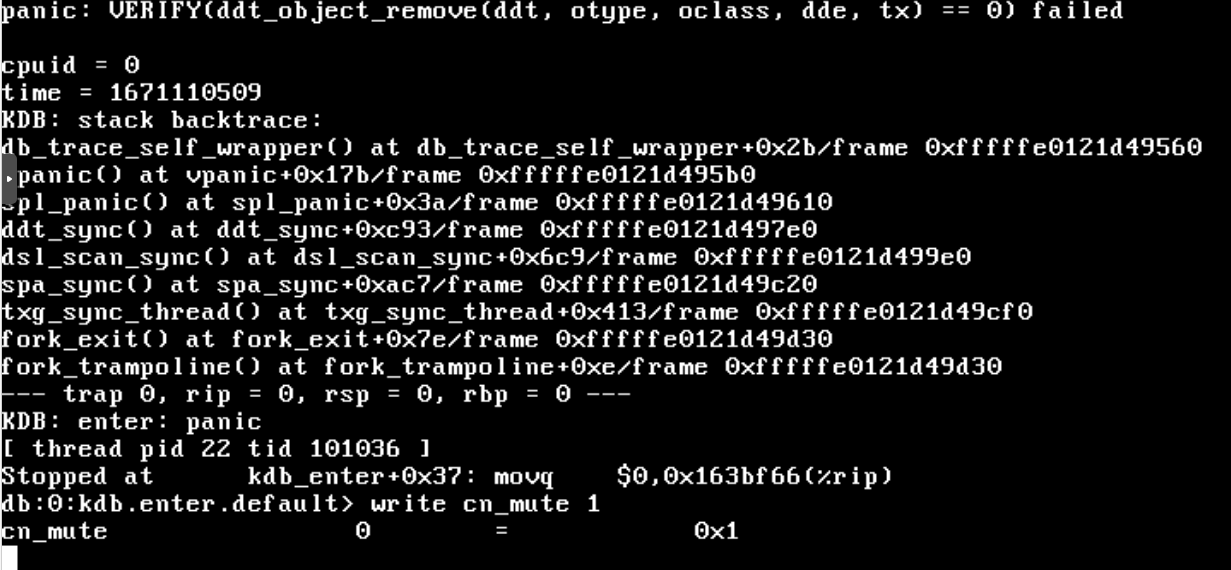

Things got worse and TrueNas does not even boot anymore unfortunately. I allocated 64GB of RAM (non ECC though).
This morning I was able to copy everything from the dedup-enabled dataset to a dedup-disabled dataset. But it looks like it copied the checksum error too because I was unable to replicate the dataset to my other system.
After this, the TrueNas VM shut down and now is looping in panic mode, see the pic attached...
This is before it goes into panic mode and reboots
And this is the panic

I've installed TrueNas in a spare computer and moved all the disks.
At first I was able to get to the GUI and click on "import existing pool" (despite not exporting it before). At the import the result was exactly the same, and now the bare-metal PC is showing the exact same error.
So I've excluded the virtualization as well as the PCI card (all disks are now directly SATA-connected to the MB) and I'm in the most basic setup possible.
I think it's somehow too late, and the damage is done to the data, or at least the metadata.
Looking for this issue, I've hit some threads where people were using dedup as well and their systems crashed during a zfs send (as it happened for me) :
https://www.truenas.com/community/threads/pool-import-or-system-boot-causes-kernel-panic.83370/
https://www.reddit.com/r/zfs/comments/fpnxkr/zfs_pool_wont_import/
https://github.com/openzfs/zfs/issues/11480
https://github.com/openzfs/zfs/issues/1681
Unfortunately, from what I've read, I could not find a solution in these thread.
Do you guys have any idea how I could solve this issue ?

root@truenas[~]# zdb -eC Storage
MOS Configuration:
version: 5000
state: 0
txg: 11537028
pool_guid: 7403891478952984555
errata: 0
hostid: 570136887
hostname: ''
com.delphix:has_per_vdev_zaps
vdev_children: 1
vdev_tree:
type: 'root'
create_txg: 4
children[0]:
type: 'raidz'
guid: 8486786016643024091
nparity: 3
metaslab_array: 45
metaslab_shift: 38
ashift: 12
asize: 127989985574912
is_log: 0
create_txg: 4
com.delphix:vdev_zap_top: 36
children[0]:
type: 'disk'
guid: 17013278204322199397
path: '/dev/gptid/650c6126-01ad-11eb-883c-21daca7daacf'
DTL: 22160
create_txg: 4
com.delphix:vdev_zap_leaf: 37
children[1]:
type: 'disk'
guid: 14228971779810250931
path: '/dev/gptid/d120cdee-3667-11ed-ac19-7d1fb4d87bfd'
DTL: 120519
create_txg: 4
com.delphix:vdev_zap_leaf: 120146
children[2]:
type: 'disk'
guid: 8351602675821245731
path: '/dev/gptid/6845548d-01ad-11eb-883c-21daca7daacf'
DTL: 22158
create_txg: 4
com.delphix:vdev_zap_leaf: 39
children[3]:
type: 'disk'
guid: 4518851381625534046
path: '/dev/gptid/7e3e9129-c9fa-11ec-ac19-7d1fb4d87bfd'
DTL: 44485
create_txg: 4
com.delphix:vdev_zap_leaf: 44827
children[4]:
type: 'disk'
guid: 3563226997516867113
path: '/dev/gptid/6a4b706d-01ad-11eb-883c-21daca7daacf'
DTL: 22156
create_txg: 4
com.delphix:vdev_zap_leaf: 41
children[5]:
type: 'disk'
guid: 17446234952857385234
path: '/dev/gptid/d1602ec6-ea4b-11eb-9f3a-a5e7552b2c10'
DTL: 113
create_txg: 4
com.delphix:vdev_zap_leaf: 669
children[6]:
type: 'disk'
guid: 6073306176661101619
path: '/dev/gptid/6d163391-01ad-11eb-883c-21daca7daacf'
not_present: 1
DTL: 22154
create_txg: 4
com.delphix:vdev_zap_leaf: 43
children[7]:
type: 'disk'
guid: 10746640750719053050
path: '/dev/gptid/6d24a6e6-01ad-11eb-883c-21daca7daacf'
DTL: 22153
create_txg: 4
features_for_read:
com.delphix:hole_birth
com.delphix:embedded_data
jgreco
Resident Grinch
May 29, 2011
18,680
zfs mouns -Fn
I have no idea what "-Fn" is. Lowercase "-f" is force.
So either the copied files conserve the dedup parameter,
That can't happen, at least not the way you outline. When UNIX copies a file, it does an open() syscall on a new file and proceeds to read from the old file, writing into the new file. That's what you want to happen in this case.
or the deletion of the dedup dataset failed and now we are in this state where TrueNas tries to reference some data with dedup enabled, but this data does not exist anymore...
So one of the problems with ZFS is that there is no "fsck" or "chkdsk". As I have said MANY times over the years, once some form of corruption is successfully introduced into the pool, it becomes persistent. This goes for stuff like non-ECC memory corruptions resulting in cosmic ray splorf'ed data being written out to disk with a fresh valid checksum, but it ALSO applies to stuff like metadata blocks. So now play along for what I suspect may have happened.
Metadata is system-critical data, although I believe some of it is exempted from running through the DDT mechanism (I'd have to go digging as it's been awhile; most metadata is not a candidate for effective dedup.) However, even if you delete all the files, directories, snapshots, and other directly user-affectable instances of dedup, there may be some blocks that are still legitimately active and therefore part of the DDT. If so, only the act of freeing all copies of the block will result in the DDT entry being freed.
However, if there was some sort of major I/O operation going on (massive deletion, snapshot reclamation, etc), and the system crashed, I suspect it is possible that things got into a bad state. Once you lose a referencing link to the data, there's no longer anything that will ever cause that data to be purged from the pool, and you have ghost data floating around. Remember what I said about no fsck or chkdsk?
So, is there a way to purge this table manually ?
No, not really. It is easy to know WHAT data has been subjected to DDT, you just dereference the pointer and look at the block. However, that pointer could have come from ANYWHERE. Is it part of a snapshot? Part of a file? You would have to traverse all the metadata on the system looking for references to that DDT table entry.
Those of us who have been doing this for some time treat the DDT as a table best purged by destroying and rebuilding the pool.
Okeur75
Nov 16, 2022
36
From the man page : Recovery mode for a non-importable pool. Attempt to return the pool to an importable state by discarding the last few transactions. Not all damaged pools can be recovered by using this option. If successful, the datafrom the discarded transactions is irretrievably lost. This option is ignored if the pool is importable or already imported.

Try mounting it read-only, as you're getting the panic from a DDT update:
zfs mount -o ro Storage
If you can do this, you'll want to copy the files to an entirely separate pool (not just a dataset)
After some tries, this works. I was trying everything I could to prevent this from happening because I have 38TB to transfer, but it looks like my last resort.
