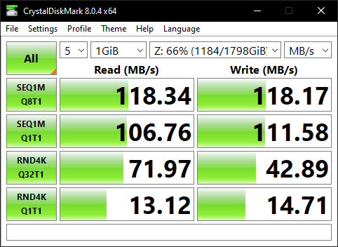

A simple SMB share with 2x5400rpm drives in a mirror gave me the following results:

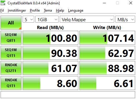

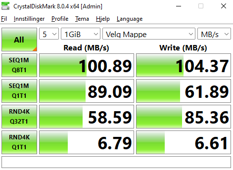

Here is the crystal diskmark for the iscsi share:
Here is the crystal diskmark for the smb share:

@Ikon , I really think there is a misunderstanding on your end about what speed is possible. To me those speeds are perfectly acceptable for your hardware.
Edit: What would be your expectation?
ChrisRJ
Oct 23, 2020
1,919
Since I have 1gig ethernet I would expect 1gig transfer speeds
That is your misunderstanding :smile: . You do get 1 Gbps speed.
As @HoneyBadger mentioned, the 1 Gigabit per second of your network correspond to around 100 Megabyte per second in transfer speed.
